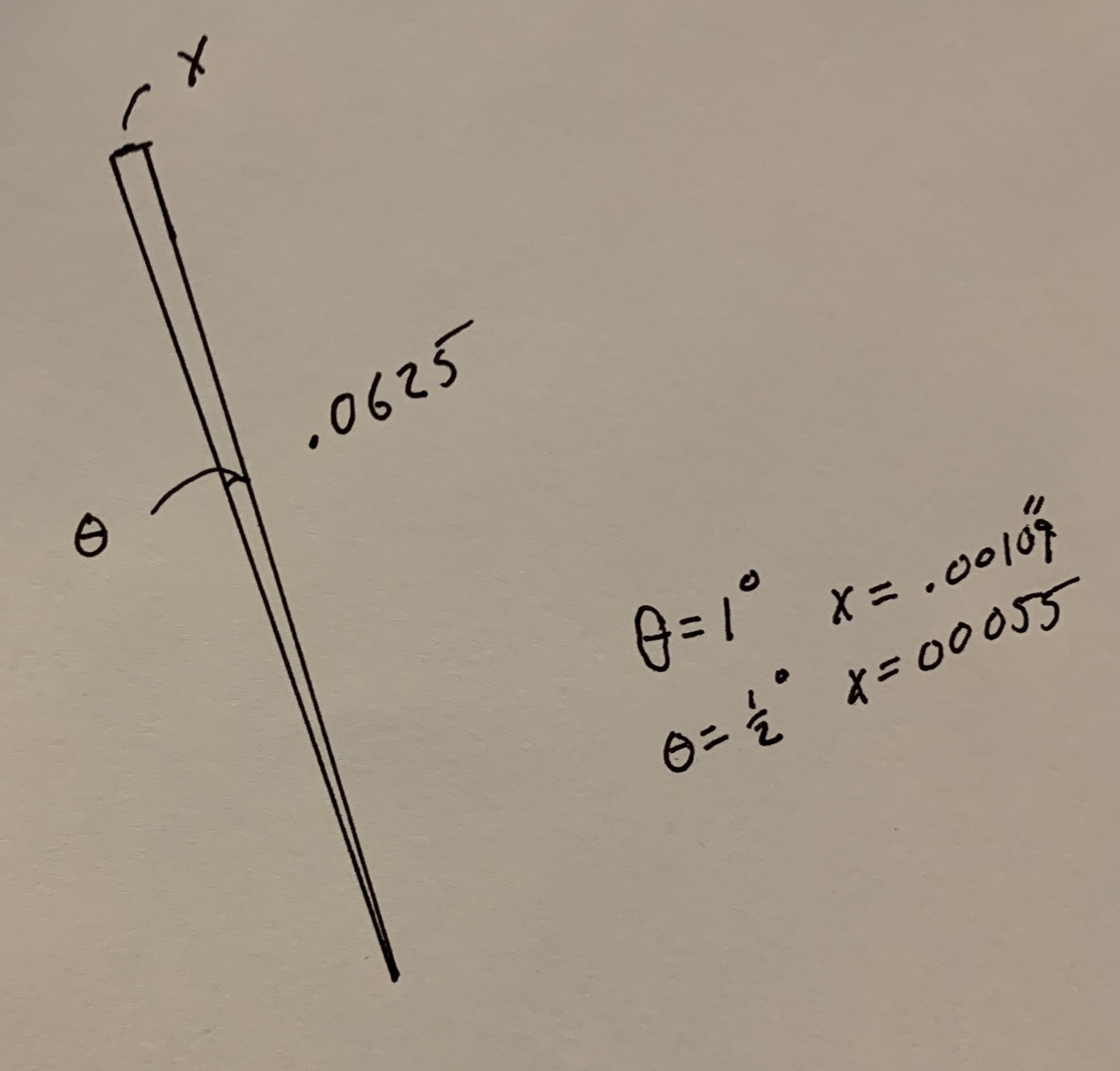

As the attached photo illustrates if your secondary bevel is 1/16" and you are off one degree between stones you only have to remove .001" material to creat a burr if you are off - 1 degree. If you are off + 1 degree you would get a burr right off.
Being off one degree might mean some extra strokes to remove the material, but weigh that against the time it takes to check and reposition your stones.
In the end, as long as you creat a burr between stones you should be good to go.

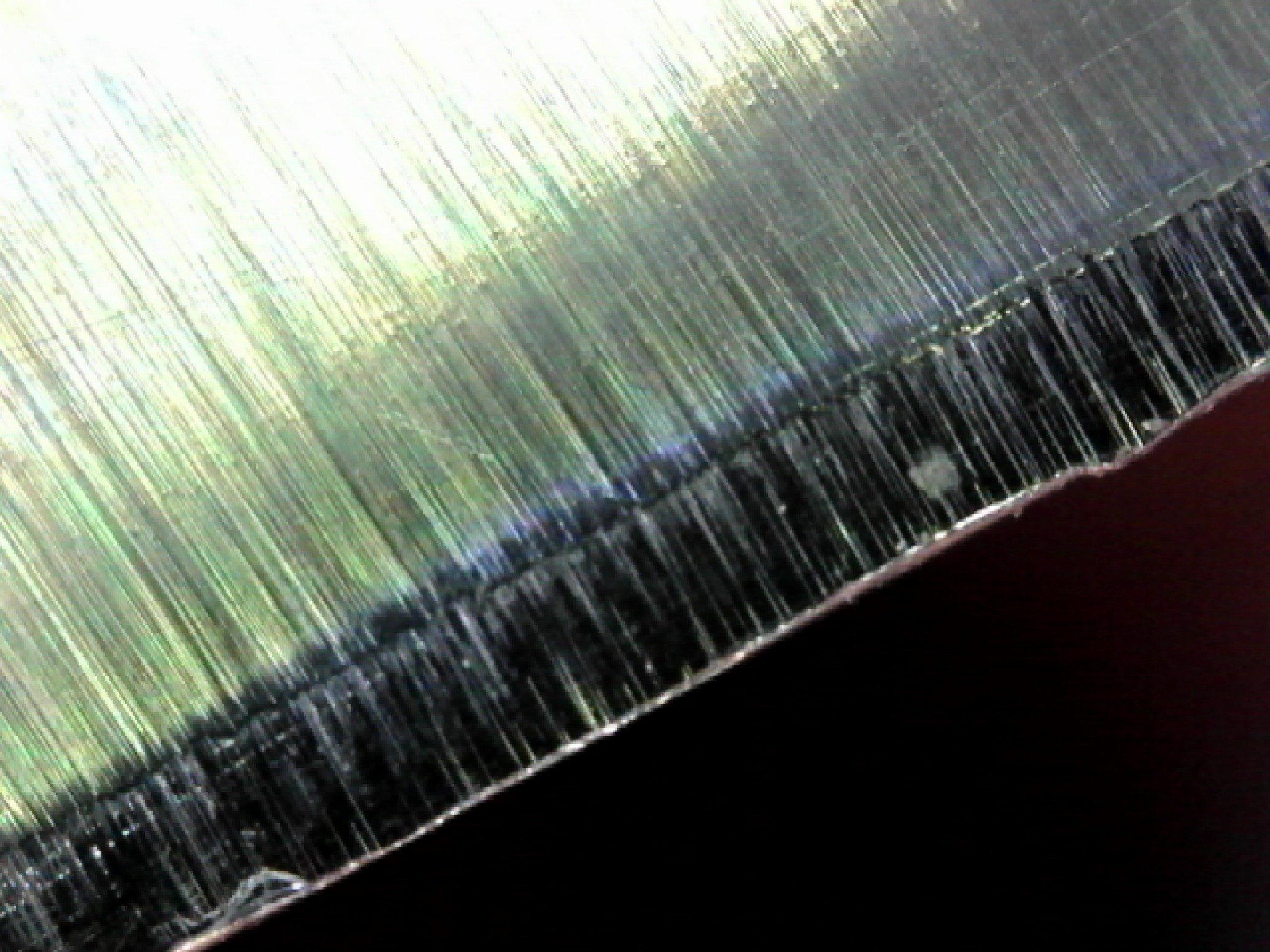

Before:
After:
