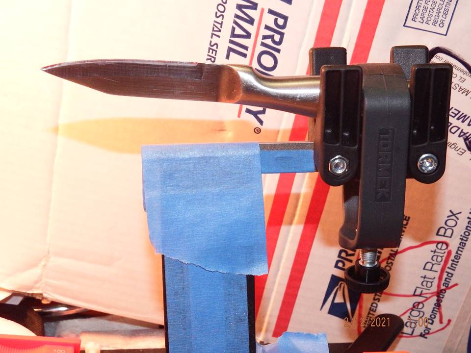

I don’t own a dagger, but I believe that using chamois around the dagger would help. I used some pig skin that I use for lining holsters and sheaths with and it works great holding onto knives with. A photo is always helpful when you ask questions.
You can maybe use a Tormek SVM-00 small blade adapter also. I bought one and it works great. I used it for a small paring knife. Below is a photo of it. My pig skin is only 0.0265" thick. So the chamois may work better for a dagger if it is a little thicker. And just be careful clamping it in the vise. Or maybe try the Tormek. I would bet that it can be done. My Boker Plus Kalashnikov 74 Auto is a dagger type blade but the top edge is unsharpened. I polished the edges up great on it. Where there’s a will, there’s a way.

also, is that electrical tape that you’re using to secure the Tormek to the WE?

Also, you will notice that I used blue painters tape with my Boker auto. The blade did slip a little in the clamp while sharpening and I had to keep an eye on it. But I’ll bet that if you use a piece of chamois leather like Marc teaches, the clamp will hold the blade much better. Right now I am using black pig skin but I’m going to get some leather chamois soon and get it a try.
I am using blue painters tape (masking tape) to help the clamp face grab the blade, and Tormek mounting bar, better. But as I said in the other post, the pig skin works better. And leather chamois works even better than the pig skin I would imagine. I’ll probably never use masking tape again.
