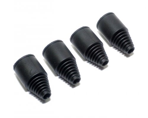

Found mine on amazon but also have seen similar on ebay:
http://www.amazon.com/gp/product/B00MVU5T5I?psc=1&redirect=true&ref_=od_aui_detailpages00

It will of course come down to personal preference. I can say these rc car boots are thinner material and quite soft n flexible. More so then they appeared.
I use these, too. They work quite well.

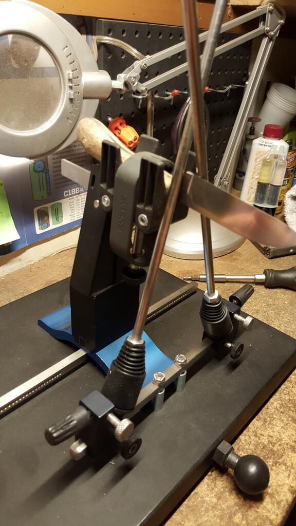

Update: After cutting a small notch in the side and installing the boots I can report they swing and move free of any resistance. I sharpened a few knives last night and didnt even notice they were there.
For the cost of approximately $10 I would say this minor mod is a major upgrade both to form and function of the system. It certainly beats by a mile the cut off tip of a rubber glove(that also worked just fine).
Shown below is my current complete WE system with most if not all of the mods visible…Double riser block, tormek small knife jig, extended length rods, micro adjust knobs, front rail for extremely low angles, ball joint for support mount(rarely use), and the new excellent ball joint dust covers.
I’m having trouble trying to find these R/C axle boots. Do you know what brand they are, or what the stock number is?
Looks like the old link expired. I went into my purchase history, found it, and searched it again. He is the exact same one Im using:
http://www.amazon.in/Mad-Max-Yyb29-Madmax-Rubber/dp/B00MVU5T5I
There are many more, just search rc car shock/axle boot/cover. I wished I could have found mine in a matching blue color but black works. :stuck_out_tongue:
Thanks Cliff that helps bunches!!!
