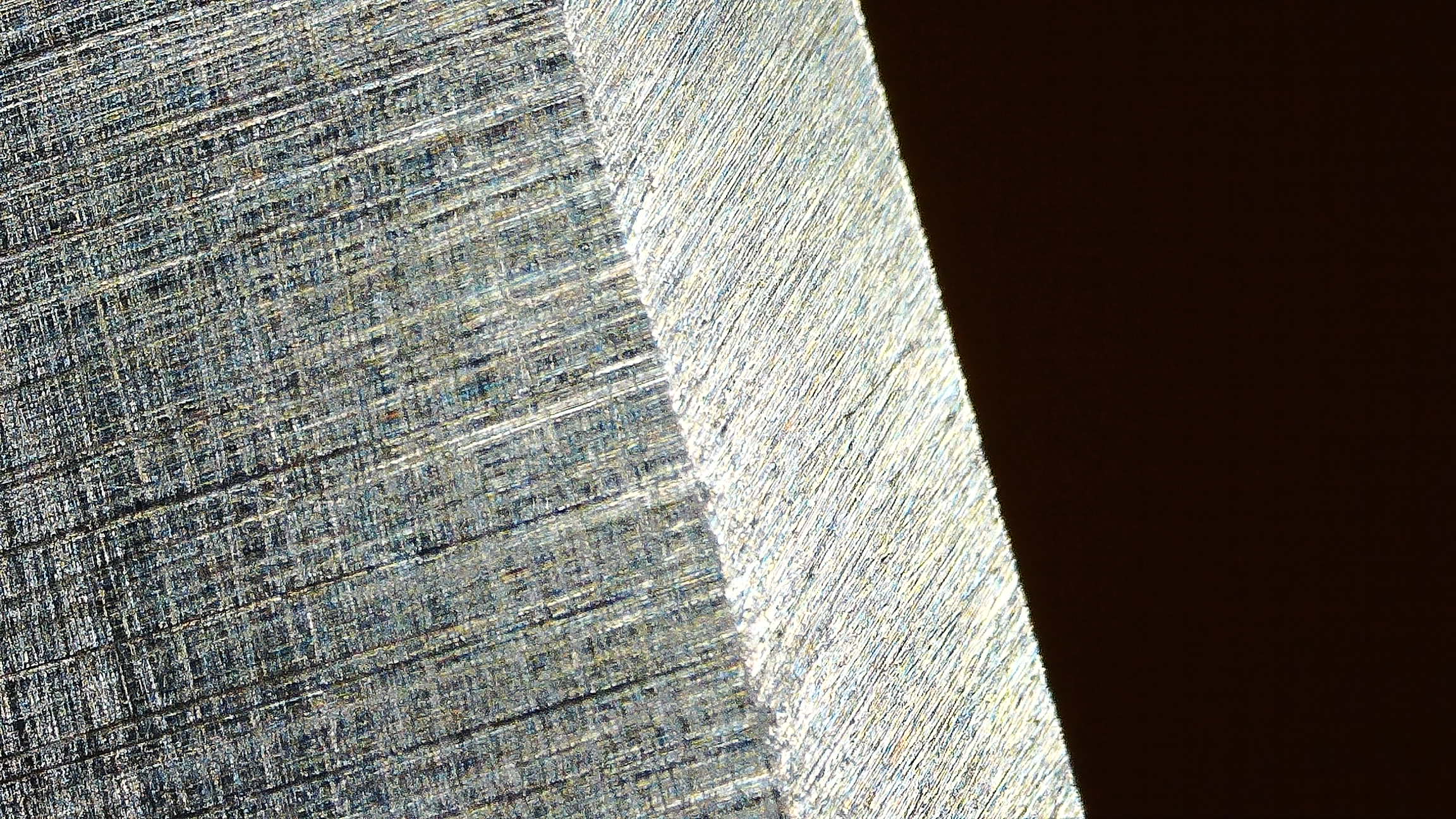

The Celestron MicroDirect 1080p HD arrived on Monday and since then I’ve used it while sharpening several knives.
The microscope is 6" long, which is probably larger than most of the microscopes that have been discussed on this forum in the past. And it has two cables that connect the end of the microscope to the display (one is a USB connection and the other is an HDMI connection) instead of the single cable many other microscopes require. But the microscope is very light, and I found it very easy to use.
When using the microscope, I simply placed the end of the microscope on the blade of the knife I was sharpening. I’d attached a couple of short pieces of plastic rod to the sides of the microscope and positioned these pieces of rod so that, when they were placed against the edge of the knife’s blade, the microscope is immediately lined up with the with the apex of the knife. And I found that, once I focused the microscope, I could use the microscope with the rest of the knives I was sharpening with little or no adjustment to the focus.
Note that, when the end of the microscope is placed against the side of the blade, there are depth of field limitations because the microscope’s lens is so close to the knife’s blade. Consequently, when used in this way the microscope will only focus at 50x and 200x magnification. But that definitely wasn’t a problem given how well the microscope worked at 200x magnification.
The microscope also has a slot for a MicroSD card. This allows you to press a button on the side of the microscope and photograph the image that the microscope is showing on the display. To transfer a picture to your PC, you take you simply have to plug the UBS cable into the PC.
Below is one of the images that I took while sharpening on of my knives

It has. I was particularly helpful as I was trying various approaches to burr/wire-edge removal. It allowed me to see what the impact of each approach was on the edge and the scratch pattern.
