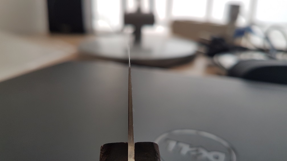

Here you see the result:
Yes, the knife is sharper than before. But not as sharp as I expectated.

The light reflecting off of the apex in your photos says something isn’t quite right. Except for the procedure you describe, my first guess would have been that you are leaving a burr on the edge, or you’re not really achieving an apex. I would hold a light directly over the edge and look straight down on the edge, looking for reflected light. A clean apex should reflect no light.

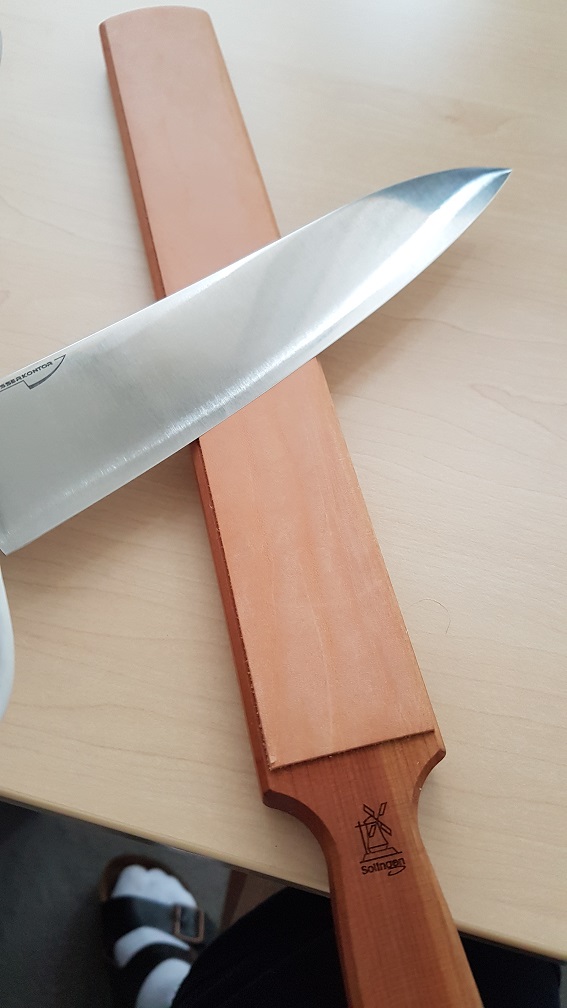

It may be the stropping but I don’t think it’s because of the angle. I don’t use the leather strops delivered with the WE but this one:
The angle I use looks like this:
I use only two strokes for each side of the knife (alternating). But I will test what you suggested and control the sharpness before and after stropping.

My comment about the stropping was based on the assumption that you were using the WE strops. I’ll assume now that you’ve determined that the strop is not dulling your edge. A couple of comments then…

Whatever path you take to solve your problem, I’d suggest that you focus first on why you have the light reflected off of the edge. It simply shouldn’t be there.

The W.E. lends the angle control ability to your stropping that you can’t get with hand stropping. I don’t believe you’re rolling the edge stropping as lightly and as few times as you’re describing even with the plain leather hand strop with out the compound. I’d look back at the early steps to be sure you are apexing the knife edge with each and every grit.

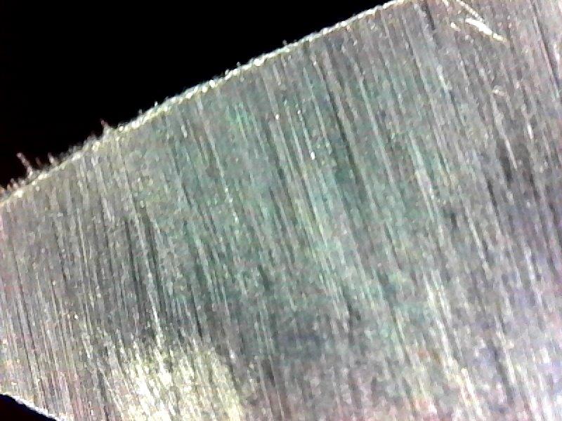

I draw a burr with each and every grit I employ. It’s not by intention it just is by the nature of my technique. I don’t look to avoid the burr formation. I simple work with it and remove it each and every grit. I use the burr formation to assure I have apexed the edge. I remove this burr each and every grit with alternating side, left-right-left-right, edge leading strokes, that is down and onto the edge, to exposed the apex. I do not count strokes. I do what number of strokes which is necessary to achieve the results I’m looking for. Whether it’s 10 or 50 or 20 or 5 strokes. Just what’s necessary to see, with the high power scope, the edge I’m looking for. When I see the scratches transitioning up and off the edge on both knife sides, evenly along the entire knife’s length, heel to tip, only then do I move on to the next grit.
The scratch pattern at the very apex of the knife edge is a very fine toothy looking edge. The scratches make little grooves in the apex as then transition up and off through the thin steel of the apex. Even with 3000 grit, this very fine toothy edge is lightly yet barley visible with the high power scope. Still it’s there and can be felt with a finger fell or a paper cut test.
The subsequent stropping smooths this toothiness some for me to give the final smooth gliding cut I’m seeking.
I wanted to add these photos to illustrate what I wrote above. This shows a knife edge of a clamped knife, (in the W.E.), that was sharpened with the W.E. 3000 grit Diamond Stones.
First is a photo of the Burr formed at the knife tip, when I first started with the 3000 grit diamond stone. The subsequent alternating side edge leading strokes knocks the burr down and/or off.
This photo taken with USB scope at high power. (Same knife). You can see the jagged tooth apex showing where the scratches trail up and off the edge. This scratch pattern is from alternating side edge leading strokes.

Might be too late, but could you shoot a picture straight down on the edge to show how much reflected light a truly keen edge should have?
Ed K.
Yes, That’s tcmeyer’s method, also. Thanks
