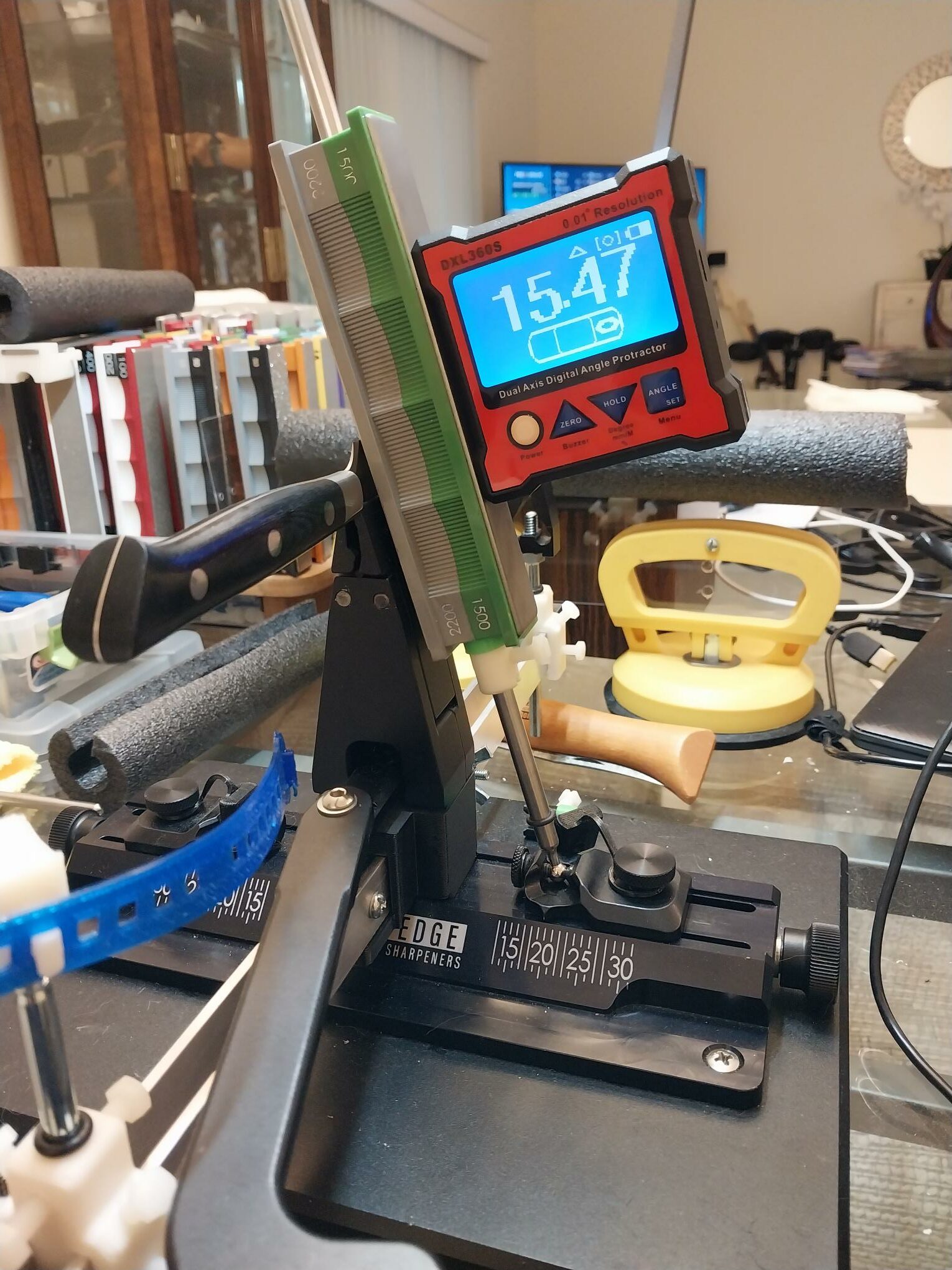

I currently own a WE120 and decided to upgrade to the WE66. I’m a big fan of the new clamp, especially for FFG blades. The micro-adjust is perfect. The problem is that I’m now seeing a few new issues that I did not expect.
  1. I clamped a paring knife and just scraped the edge of the clamp. Just a regular Henckels 4" paring knife at a 20° angle. Since the clamp sits lower than my WE120, it doesn't seem like I can do any reasonable angle with very small knives or even steak knives. It doesn't make sense to me to buy the low angle adapter instead of just keeping my WE120 for small knives.
  2. Since the WE66 clamp is a little shorter than the WE120, I can't clamp a dagger sized blade like the Busse FMV8. It's about 1.5" in width and the clamp has nothing to grab onto since the middle of the blade is too high. With the WE120, I was able to go all the way down to the first screw and clamp it.
Any ideas from the more experienced WE users here? Worst case scenario is that I just keep the WE120 and use it for things the WE66 doesn't seem to do.
