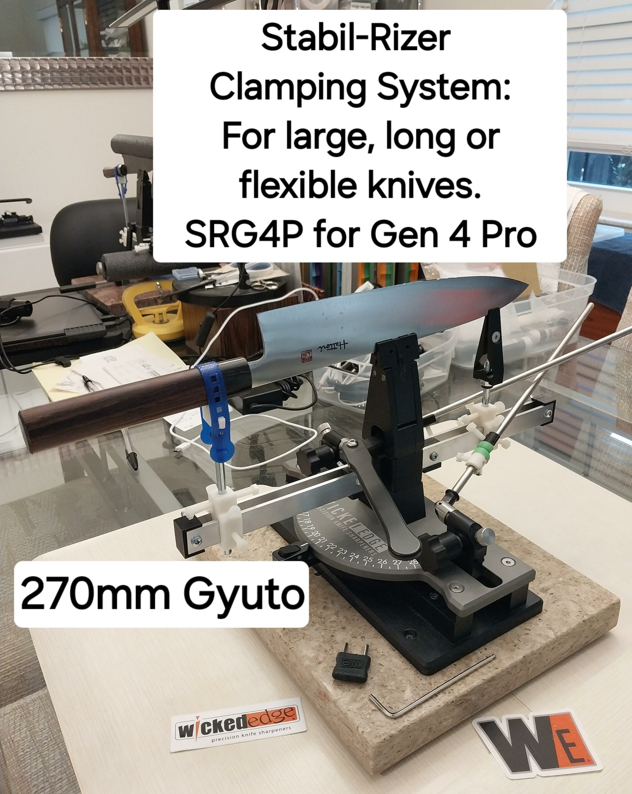

What do you think of how sturdy the knife is clamped in the vise?
As mentioned, my wolfcraft sharpener doesnt clamp it very well and the knife moves a fair bit when sharpening. Even the weight of the stone is enough to push the bevel angle out considerable.
The Dual-Cam vise, included with the Gen 4 Pros and WE66s, clamps and holds very well for most knives. Since I sharpen mostly full-size chef’s knives, I do always work with a Stabil-Rizer Clamping System Accessory on all my WEPS setups. This is for added rigidity, and lateral or rotational stability.
The Micro-angle adjusters allow you to utilize the full precision and accuracy the WEPS offers. With the adjusters you can match the precise bevel angle(s) applied by the knife smith.
My WE sharpeners are mounted on heavy bases to enhance user’s stability.
