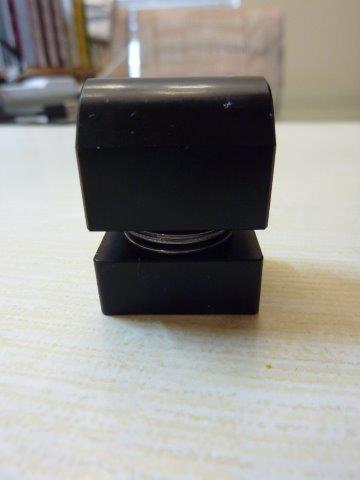

Hello guys. My WE130 just made it home today! Is the washer stack right? It has 6 sets of washers, and the photo in the Wicked Edge clamp disassembly/cleaning shows a washer stack with only 5 stacks of washers. I am wondering if there is a mistake.
It seems to be working just fine, so I guess it is ok.
Some people find the camp requires too much force to close even with the adjustment and reduce the number of washers. The washers are actually the springs that provide the tension.

There is been a slight design change to the whole cam follower and washer stack and we added two more washers to the newer units.

I was just doing some maintenance on my Gen 3 Vise the other day. I was playing with the number of the belleville washers in the washer stack curious the effect it had on the clamping tension. I tried the vise with less washers in the stack like was shared earlier in this thread, and in another thread discussing the same washer stack issue.
My observation was when less washers were used the total range (-) to (+) in the tension adjuster was diminished. Yes the final tension when the blade was clamped was less but also the total tension at full (+) and tensioning variability, control and preodictability was negated.
The tension adjustments must be made preset, prior to rotating the the vise locking handle. The way the tensioner works is observed in the jaw spacing you begin with before you clamp your knife in place. The cam action and total cam rotation never changes. As the handle is rotated left to right clockwise it simply rotates the cam shaft and cam lobe, 180º, from laying down to standing up. If you observe the jaw spacing on (-) and compare it to the jaw spacing (+) here’s what you’ll see.
The less tension (-) the jaws start wider spaced. Twisting the little tensioner adjuster knob towards the (+) side the jaw spacing is diminished. The jaws close down together. After you preset the tension setting and your knife is placed between the vise jaws, it’s ready to lock by rotating the cam lock handle clockwise. The cam rotates it’s full 180º of rotation. As the cam shaft rotates it raises the linked cam lobe to simply elevate the cam assembly, that is resting on it. The washer stack, the cam follower and piston on top completes the cam assembly and it moves as one single unit. The elevating piston presses up into the narrowing “v” space which spreads the vise legs closing the jaws space closer together. All the while the piston is in contact with the jaw legs. The cam assembly rides up and down held in place in a channel between the hinged pinned jaw legs. As it’s elevated by rotating the locking vise handle it spreads the jaw legs. This opposite reaction closes the vise jaws together. Once the jaws are touching, further piston elevation just squeezes the jaws closed tighter and applies more holding tension.
The height of the cam assembly as designed and engineered by Wicked Edge is designed to sit on the cam lobe as it also just contacts, or almost contacts, the jaw legs. As the tension setting is rotated (-) to (+) the cam assembly is elevated engaging the jaw legs further up and reducing the jaw opening. Reducing the washer number in the stack lowers the overall height of the cam piston. On (-) tension the piston doesn’t even contact or engage the jaw legs. All the tensioning adjusters variability is wasted just to engage the shortened cam assembly. The tension variability is lost.
The distance the cam rotates and the cam lobe size is constant. It can only lifts the cam assembly that one fixed distance. The tension adjuster works by elevating the cam shaft as you increase the tension setting In (-) tension the cam shaft, is flat seated down in the curved housing’s cradle, as low as it goes. At (+) full tension, the cam shaft is elevated by two raised brass bushings, as high as the cam shaft can be raised. When the cam assembly is used as designed, it is in constant physical contact with the cam lobe below and the jaw legs above. This can be tested by rotating the tensioner. The starting height of the cam shaft and hence the cam lobe sets the starting spacing of the vise jaws. The higher the cam shaft is, the higher the resting cam assembly is, and the higher up the piston is engaged between the jaw legs, as it in turn reduces the jaw line spacing.
Using a higher (+) tension setting starts the cam elevated higher into the “v” gap in the jaw legs and closes the jaw spacing. When the vise lock handle is rotated clockwise it still completes it’s full 180º of rotation and the piston is elevated that corresponding distance pushing the piston up inbetween the pinned jaw legs and closing the jaws tight, then tighter. When the jaws can’t close any closer together they squeeze the jaws tightly and this cause the thinner aluminum jaw tips to flex.
On (-) tension you begin with the cam shaft lower, and thus, the cam lobe lower, so the lower piston is now just contacting the jaw legs, but not yet engaged enough very far up in the “v” gap so the jaws are therefore spaced full apart. After rotating and locking the vise handle the piston has still been raised the same distance by the cam but since the piston began on (-) tension it’s position was a little lower to start so it doesn’t end up as high. The jaws end up closed and touching with out as much squeeze or tension. By the springy nature and the thinned profile of the aluminum vise jaws they flex as they are closed tighter and grip the knife with increased tension. On (-) the jaws start full apart and end up closed tight. On (+) the jaws start closed somewhat and end up closed past just full closed to be squeezed shut so tightly they squeeze and flex under the tight pressure.
Now for the point of contention. By removing washers from the washer stack, you are in essence reducing the over height of the cam assembly and therefore lowering the height of the piston. So all of the tensioning settings may be reduced or negated. It was in my observation I recently made, with less washers and without the proper beginning height for the piston, even though adjusting the tension (+) did elevate the cam shaft as expected, it didn’t matter very much. Since there are less washers in the stack and the assembly is now shorter, even as the cam shaft and hence the cam lobe are elevated, by the tensioning knob, the lowered piston of the shortened cam assembly now just slightly engages the jaw legs. The tension variability begins too late and is reduced overall. What happened for me was the tension adjuster had no real variability. It started light and ended similarly light.
Yes, removing washers does reduce the final clamping tension as the original thread poster desired, but it also reduces the tensioning effects, and tension variability, overall. There’s no reason you can’t achieve the same tension results simply using the tensioner. It’s simply about finding the best beginning position to give you the desired clamping tension. As 000Robert said if that tension from the lowest (-) tension setting is too tight to use then you probably need to use the 1/4" space optional jaw set. These start with the jaws spaced wider to begin with so the clamping pressure will be relatively less at all tension settings.
BTW: I was working with this new 6 washer pair, cam assembly, Clay referred to. Even using 5 of the 6 washers there was almost no adjust-ability.

I did neglect to discuss the belleville washers and their function. Belleville washers have a convex curved design. They are stacked in pairs with their curves opposite to create a space between them. This curved stacked profile gives them height and allows them to function as a strong spring as the spaces between the washers are reduced under compression. The washers and the flexible jaws working together are intended to allow the give needed, when clamping a knife, to avoid damaging the steel of even a thick knife. The washer springs apply a controlled heavy pressure as the vise jaws flex.

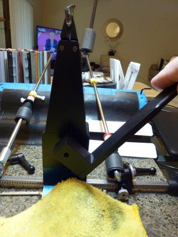

I like to work with the vise lock handle unsecured. I remove it while I’m sharpening the knife. The handle’s rotating design let’s me orient the handle so I’m always rotating down from a vertical starting position. Clockwise to lock the knife, or counterclockwise to unlock it. I found pressing down to the left is easier for me to release the vise’s spring lock than by lifting the handle, and possible the entire setup, against the springs tension.
The first (left) photo is the handle in the locking, right rotation, orientation, the second (right) photo is the reversed unlocking, left rotation, handle position.
I thought that using the belleville washers was a brilliant idea while I was examining my WE. Much more dependable than using a spring.
I leave my handle on while sharpening. I just turn the lever at a 45° angle to the clamp. When I want to release the clamp, I just put my fingers under the lever with my thumb on the base, then lift the lever with my fingers.
