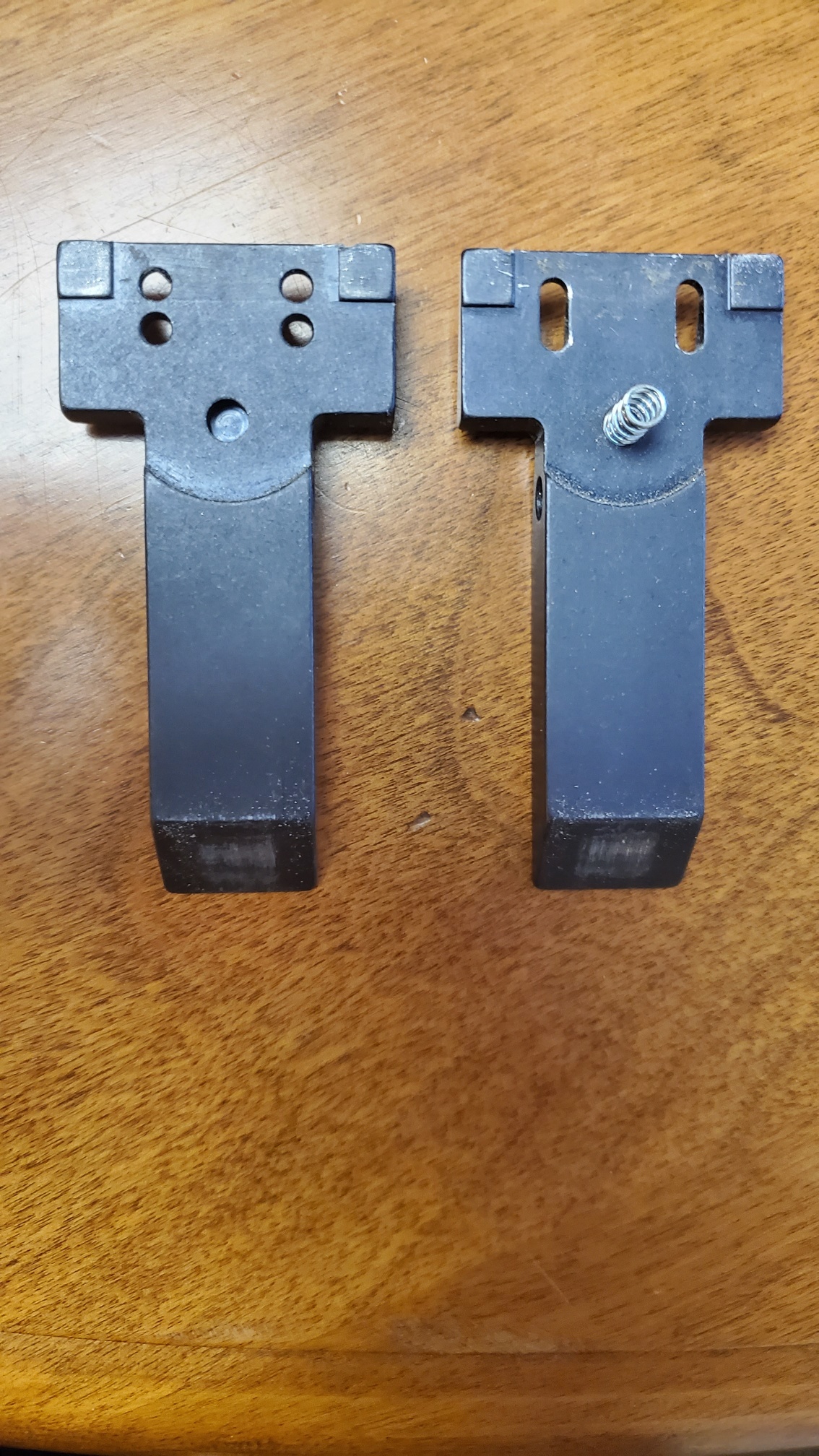

I think that the root cause of your issue is that the current jaws no longer have the square flats on them (see pic). I have the Field version from ~5 years ago. I setup my kitchen knife to check for wiggle and there is none either with my chamois insert or without it. I use the chamois to protect the knife surface from nasty little marks due to clamping. I also designed a simple fixture to handle flexible knives and low angles - cost = $5. No wiggle there either.
