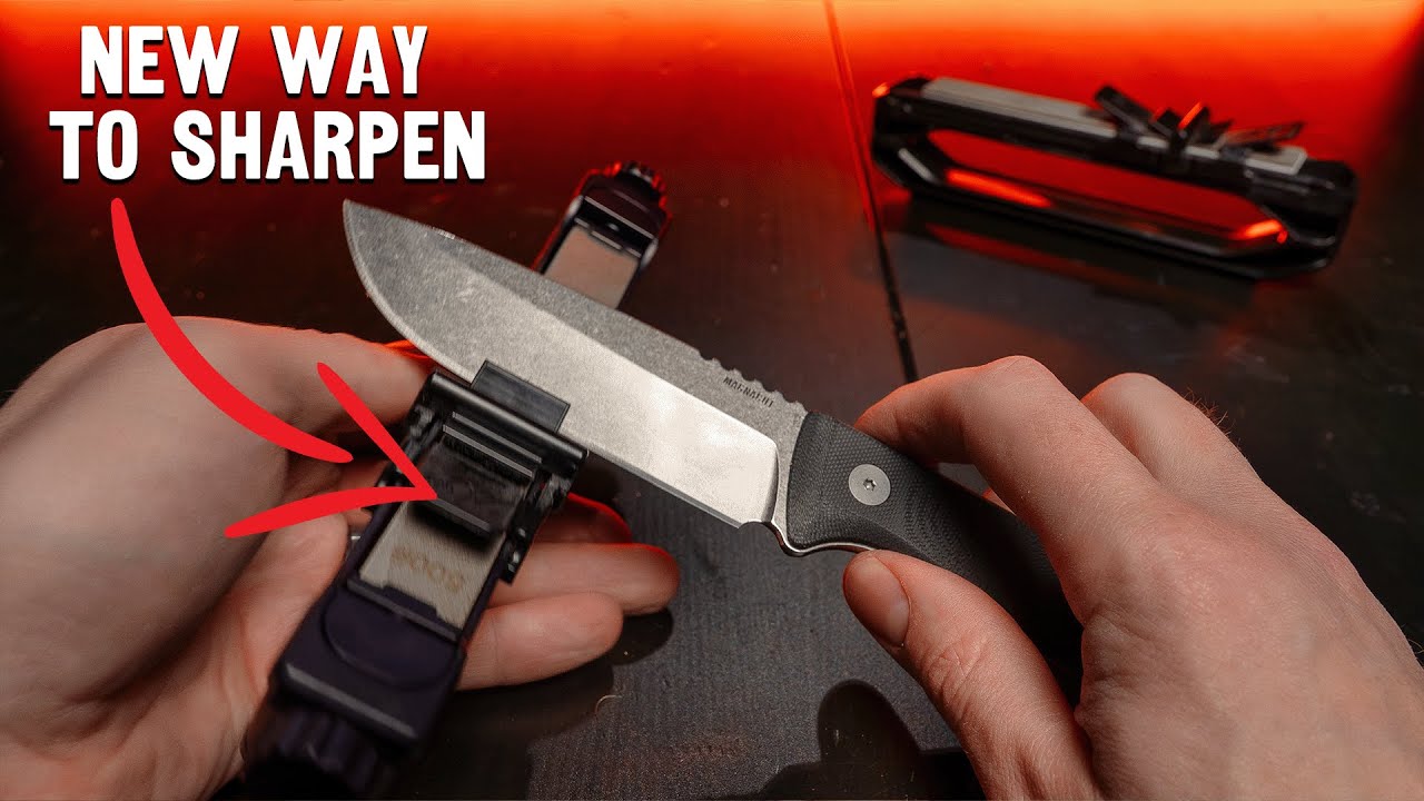

Video and Q&A from Grim Granite's Venture Series Review
Gordon (Grim Granite) has posted a great video to his youtube channel about the new Wicked Edge Venture Series. In addition there’s been some great Q&A where Clay (@wickededge ) provided in-depth answers to questions about pricing (always a guaranteed topic to come up!), 3D printing and more.
The Ultimate Backpack Knife Sharpener | Wicked Edge Venture
