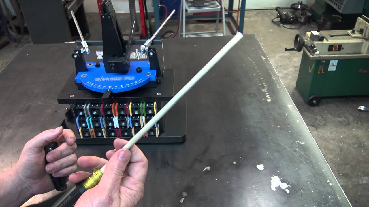

Just watched an interesting vid on Youtube of this sharpening guy who uses a WE system and recommends using a ceramic rod for touch ups between sharpenings.
I wondered this myself after my son asked me if it was OK to use his steel on the kitchen knives thatI already sharpened for him on my WE. I was under the impression (or I read somewhere) don’t steel a knife that has been sharpened by the WE.
Is there a difference between using a steel vs a ceramic? Myself and my kids all have steels that came with our knife sets years ago, but I’d be happy to buy a ceramic rod for each of us if a ceramic is the better way to go?
What say you?
Seems this site won’t allow this direct link so just search Youtube for: Touching up a knife that has been sharpened on the wicked edge.
Jende sells ceramice rods, separately and this set.
Here’s Tom’s Youtube on them: https://www.youtube.com/watch?v=FutZJATpFWo

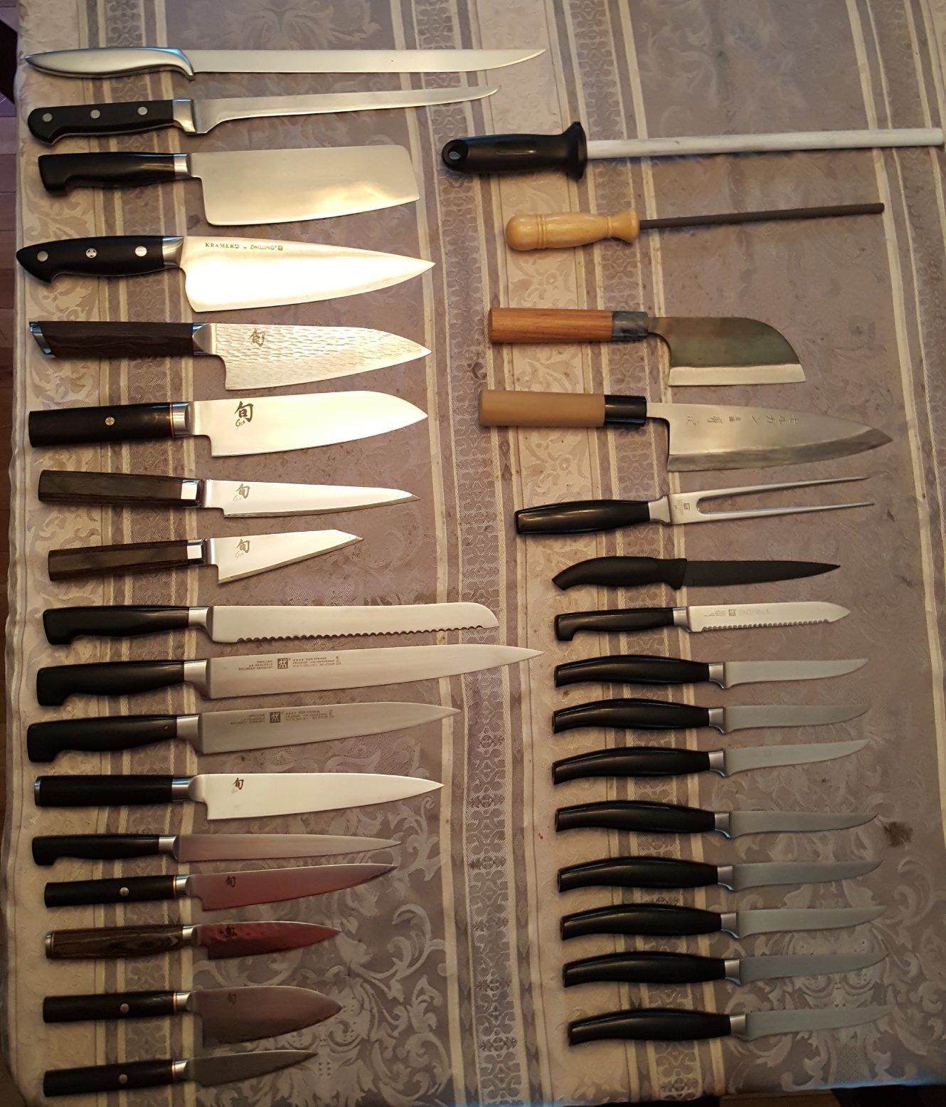

Red heads, Wow, quite a collection you have going there.. clearly you have been bitten by our knife collecting hobby :0)
and thx for the heads up on the pototential belly. I’ve already “mastered” the art of creating a recurve on several of my knives already :o(
