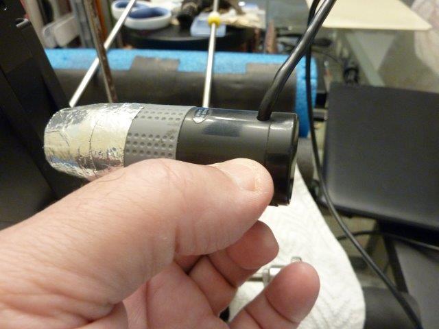

While I have time, I want to post some pictures of my pluggable scope. Since I hold the scope tight to the edge and rotate looking at the sides as well as straight down, I’ve worn a groove in the clear plastic shield. Base on a post from tcmeyer, I now wrap the shield with UHMW TAPE 19-20A-.5-18 Tape.
Once the new layer of UMHW tape is in place, I wrap it tight with blue painters tape.
https://www.amazon.com/gp/product/B01N5G0Z8Y/ref=ppx_yo_dt_b_asin_title_o06_s00?ie=UTF8&psc=1
For those just starting with the scope, you might want to take preemptive measures.
