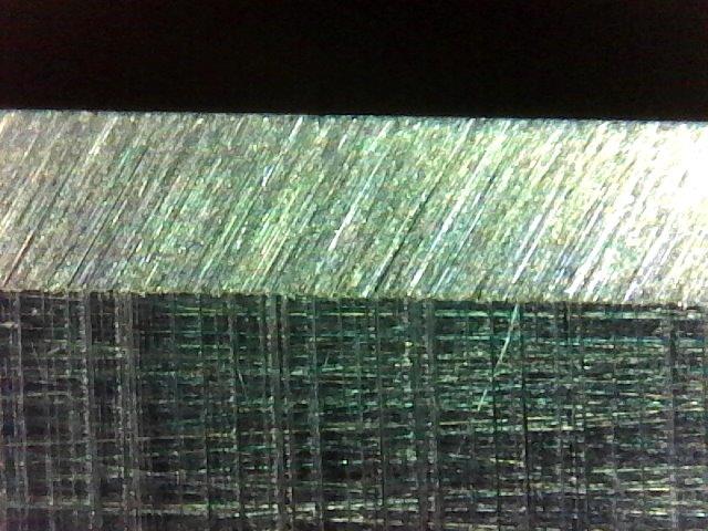

Here are photos to show the burnishing or smoothing over effect seen with stropping:
The key is to learn the balance between, stropping angle and applied pressure. This is an individualized process; a trial and error procedure. It’s often recommended to start at a 2º more acute angle then go from there.
