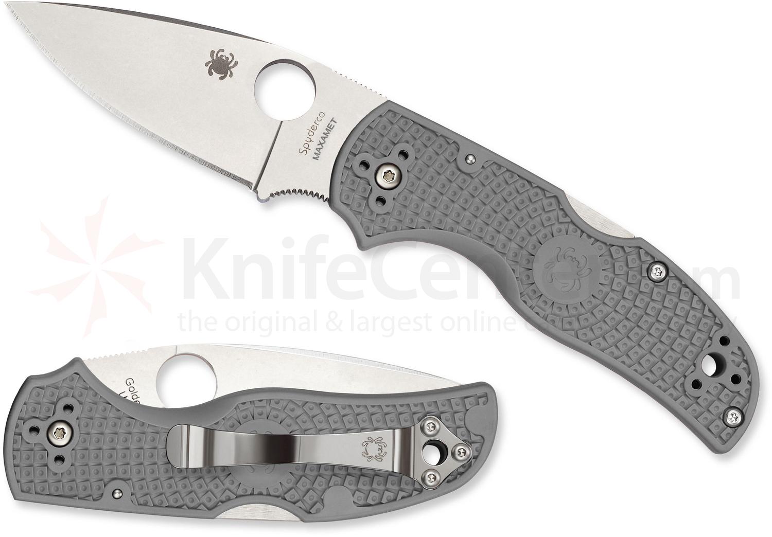

Someone mentioned Maxamet steel recently and I realized that I’d picked up a little Spyderco Native with a Maxamet blade while I was at Blade Show this year:
I decided to take it camping with me for its first outing this weekend and I really fell in love with it. It’s light and slim and feels well constructed. The blade and handle design is very ergonomic and it’s really sharp right out of the box. I haven’t sharpened it yet since it’s performing so nicely. I was curious about the way it was sharpened so I examined it this morning. Here’s what I found:
It’s sharpened at 15.5° with a final angle of 16.5° (measured by goniometer and then verified in a sharpener with the DXL360S angle gauge) and has been stropped, creating a very uniform edge that is slightly convex. The grind marks are perpendicular to the edge and are easily visible to the naked eye.
At 200x magnification, it’s easy to see the curvature of the very edge. The convex portion of the bevel is 4µ wide. The scratches measure between 1µ and 5µ with the majority in the 3µ range.
The image above was adjusted within the microscope software to highlight the scratch pattern.
I really like the way this little knife is performing and I’m curious to learn how well this factory edge holds up. Anyone else have a Native or any other Spyderco knives in Maxamet?
