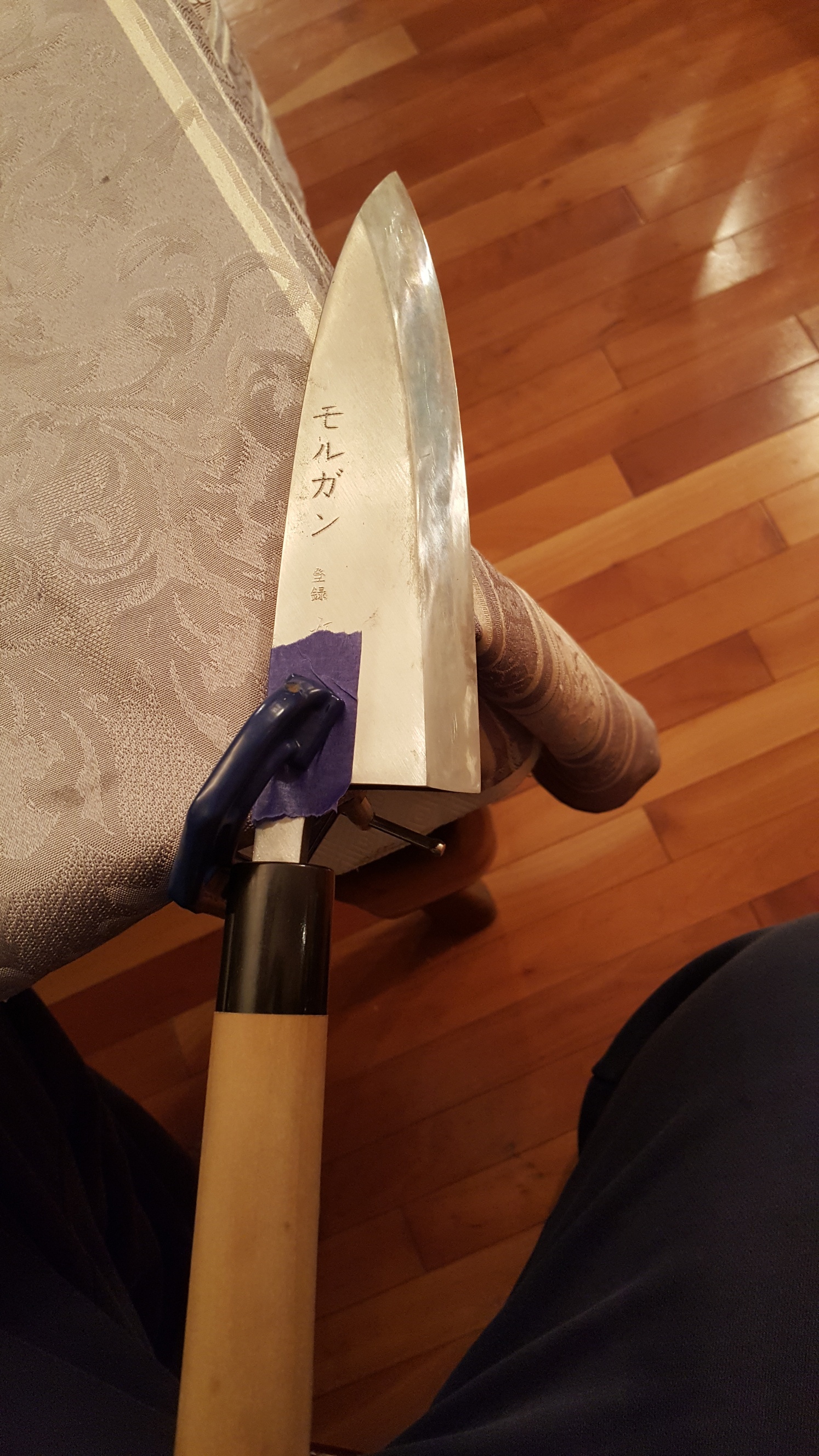

I am trying to replicate the factory single bevel on my WEPS for fun, interest and future fine tuning. It is an Aritsugu 7 inch Deba (blue steel) my son & wife brought me from Japan. It is extremely thick and heavy. The spine is ~0.25 inch thick with a one sided primary bevel ~0.5 inch in width. It is slightly dished on the opposite side. I bought the accessory WEPS jaws to hold it. It also has a micro bevel (thru USB micro inspection) which is more obtuse at the heel vs. the tip (for chopping fish bones vs. fine slicing at the tip). I mounted the blade in the hope of being able to polish up the primary bevel as well as the micro bevel. I love the alignment guide which makes future setup a piece of cake. Here is my issue:
After mounting the knife I was unable to find a position which would allow me to closely follow the original primary bevel. I know this is because it was done by hand by the original craftsmen but I figured I would give it a shot. I am familiar with Anthony Yan’s geometric analysis and how you can vary the angles based on knife position in the WEPS although I do not remember the max possible variation. I clamped the knife (see pic) to the table and using the angle indicator I determined that the primary bevel changes by ~5 deg over the 7 inch length of the edge. I know that I can keep the knife as is (it is super sharp) but someday I will need to sharpen it.

Judging from your photos, I think you can calculate the factory angle with a little trig by measuring the width of the bevels and the thickness at the bevel shoulders. You’ll want to use an angle somewhat more acute, as trying to replicate the factory bevel angle would require a very extensive stoning process.
