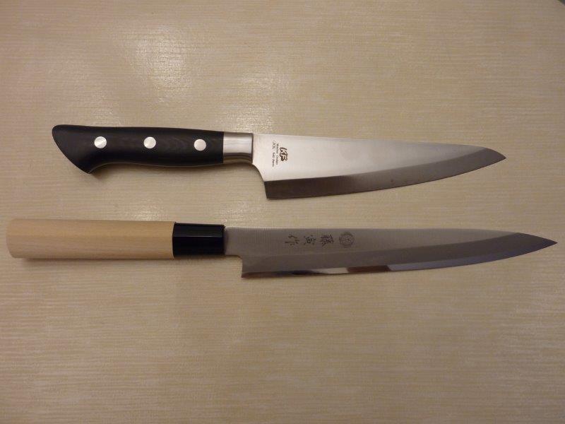

These are Right Handed knives:
On the bottom knife, the natural wood “Wa” style or Japanese handled Yanagiba (sushi knife) you can see the linear or longutudinal ridge along the handle’s right side. The pointed ridge line is particularly noticeable on the black horn ferrule. This ridge is for your right hand fingers to fold over and around to help you achieve a secure grip.
The handle shape and the right side only blade bevel grinds, help identify these right handed knives.
The top knife, the black handled Honesuki (poultry boning knife) has a “Yo” style or typical Western style handle.
The blade bevel grinds are only on the right side and the absence of any bevel grind on the left side help identify that these are right handed knives.
In addition, there are Right Handed uneven, double bevel knives. That is a bevel grind on both sides, like a 70/30, 60/40 or 90/10 grinds for examples. The more obtuse wider angles with their shorter bevel heights are on the right side and the more acute narrower angled and taller bevels are on the blade’s left side. This bevel combinationis is seen as the knife is held blade down, in a user’s right hand.
