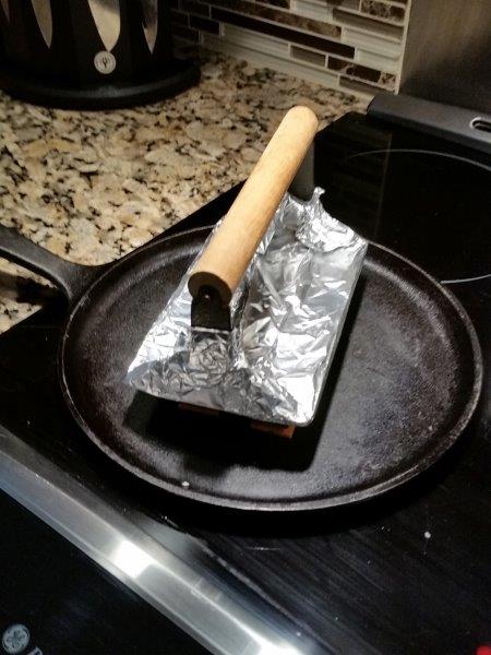

If I may ask, how did you go about re-mounting the stones on the handles? Thank you.
[quote quote=50881]
If I may ask, how did you go about re-mounting the stones on the handles? Thank you.[/quote]
I have an old hot plate - actually, I think it was used for fondue. Anyway, it has a small pot that sits on an open hot plate with the temp controlled by a simple adjustment knob. I don’t use the pot. I set the temp of the plate to about 200F and rest the face of the stone I want to remove on the hot surface. When the temp of the stone reaches about 180F, I slowly pry the stone from the handle with a knife.
Peeling the tape off is a chore. Pushing the VHB tape sideways with your thumb when it’s hot can blister your thumb badly, so wear gloves.
Having cleaned the residue of the original double-faced tape from the stone, I remount it to the new handle using three short pieces of VHB tape - one at each end and one in the middle.
Brewbear, I followed Tom’s method only on the electric range top. I used a cast iron griddle. I worked just at 200ºF verified with my IR Thermometer. That’s still a low enough temperature to not effect the plastic handles but also work efficiently against the 3M VHB double sided tape.
I let the two steel diamond stones rest against the skillet for about 5 minutes, with a bacon press weighting them down. I quickly pried the stones up and flipped them sideways, the short way, with a very thin screw driver. Like Tom said it is hot so wear safety gloves. I found at that slightly hotter temp the original double stick tape lifts right off with the screw driver if attempted immediately after removing the stones. I did the glass blanks also with the same method. (I used “Goo Gone” to remove any adhesive residue from the glass blanks. Then I cleaned them again with Windex before remounting).
Be sure to label the stone diamonds appropriately with their respective grits so not to get them crossed when re-mounting.
I asked Tom via email which VHB tape he used and purchased the same 3M VHB RP32 tape from Amazon. For the re-mounting step I found it is easier to apply the tape pieces down onto the plastic handles into the flat indented mounting pads first. Then after the tape is positioned flatly and securely, peel the backing. Then use the raised edges to help you position the stones on the indented flat mounting pads. If you place the end of the stone just against the little lip it will fit right down flat with out the other end getting caught up on the lip causing a uneven mounted stone.
I worked two stones at a time when re-mounting them. I clamped the like grit pairs face to face with a paper towel between them and a thin piece of wood on the outside and clamped them for about 5 minutes. The clamping is probably unnecessary but it won’t hurt either.
I made new labels with my “Brother P-Touch TZ Tape Printer” using “TZe-325” 0.35" Black Tape with White Writing to re-label the handles appropriately.
I want to thank forum contributor TCMeyer, Tom, for his help showing me the way in his earlier posts.
