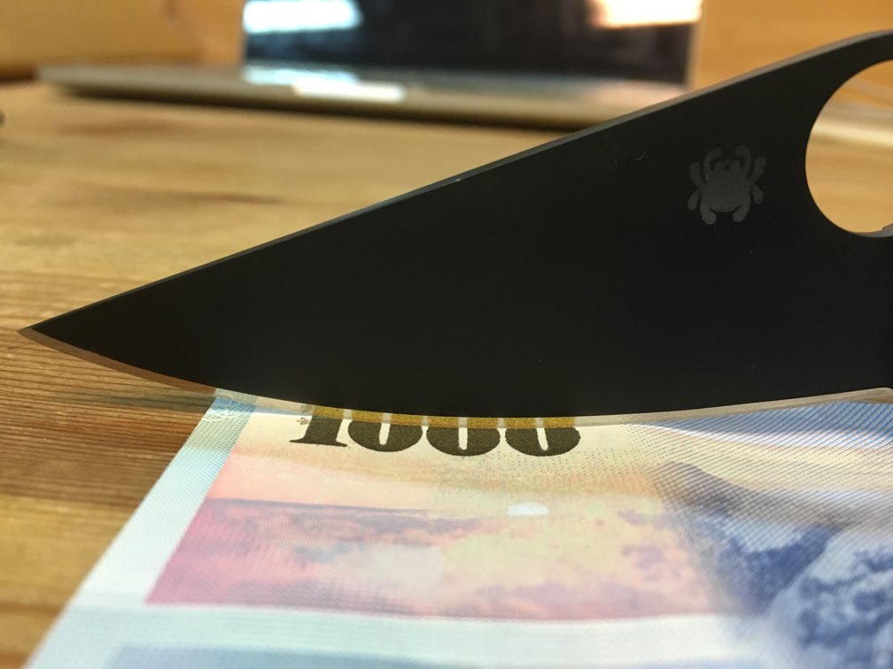

I was able to achieve this with the Lansky last night. It took three hours, though..I imagine the WE is a lot quicker! Time is precious, after all.
Spyderco PM II.
Thanks for the kind words. I do admit it looks better in the pictures than it does in real life. It’s pretty sharp–can shave arm/leg hair but not very easily. The blade “tugs” on the hairs a bit. I assume it’s because of a toothier edge? I could only take it up to the 2000 grit ceramic stone and then strop it a bit.
