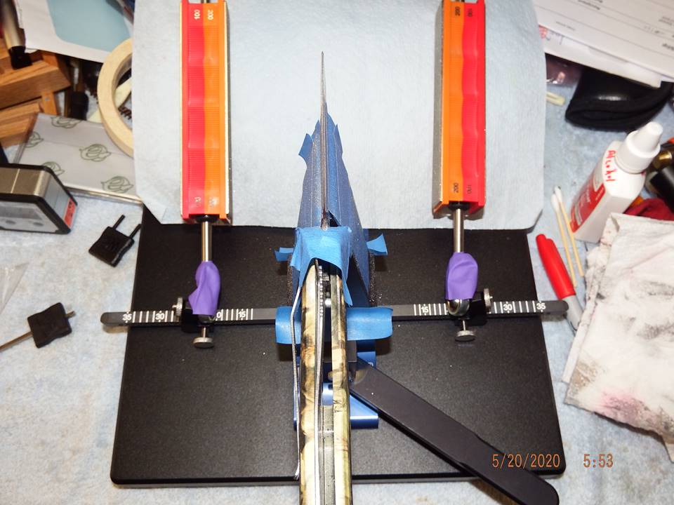

A thin strip of blue painters tape, can be applied done inside the vise jaws from the top. This helps to shield steel and diamond dust from getting down in the vise works. I prefer to use a small rectangular patch of real leather chamois that’s used to dry cars after washing. I simply fold a small chamois patch over the knife spine as I lay the knife in the jaws. The chamois helps keep the grit out and also helps provide a more secure grip between the vise jaws and the knife.

Hi Jacob, and welcome to the WE family! I use thumb tips off of nitrile gloves. Just cut them off about an inch long and poke a little hole in the tip. Then slide the thumb tip down the guide rod. I also tape my WE off to keep shavings from getting into other parts.
Edit. That is what I used so far. I am fixing to put in an order to NotSharpEnuff for some nice dust boots and other stuff.
