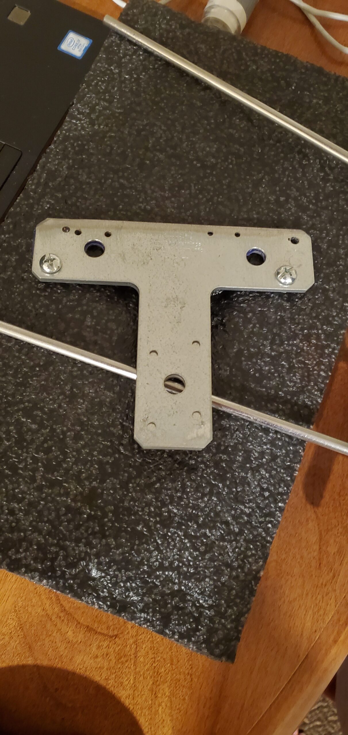

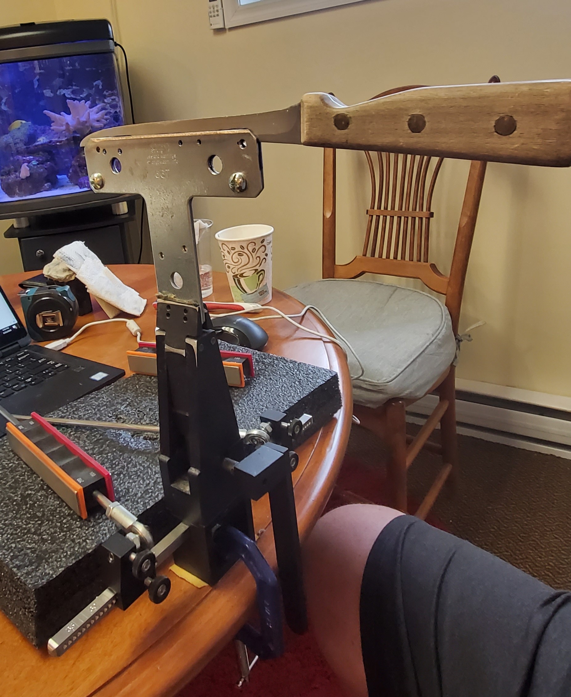

Pic below, I still had interference issues trying to put a 17 DPS edge on the knife. I could have done some grinding on the high rise but I didn’t have the equipment with me. Had to go to the standard clamp and do 3 sections with knife moves which requires blending which is a major PIA. The edge came out mirrored but with a keen eye you can see the 2 blends. I will not do blending again.
I’ve had that same knife at one time or another. Note that you can clamp it higher in the vise than what your photo shows. Anything above the flat part of the blade isn’t being held by the vise anyway. This ought to get you a lower angle. If it doesn’t hold properly, the top edge of the vise is probably bent.
