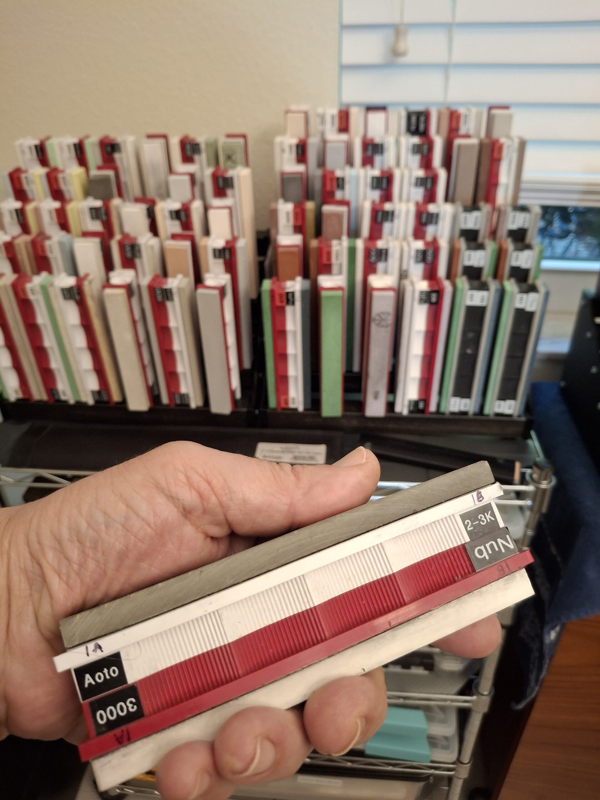

JNATS: Japanese Natural Waterstones, Tennen Toishi, or Aoto are naturally quarried sedimentary stones that have been compared and qualified for the abrasive characters like similar sharpening stones, to give them grit ratings. Generally, the JNAT are used free-hand sharpening. They can be cut to size for mounting. I do have one set AOTO natural stones that were cut and mounted to Wicked Edge Paddles. My Aoto is a fine grit finishing stone around 2000 or 3000K.
