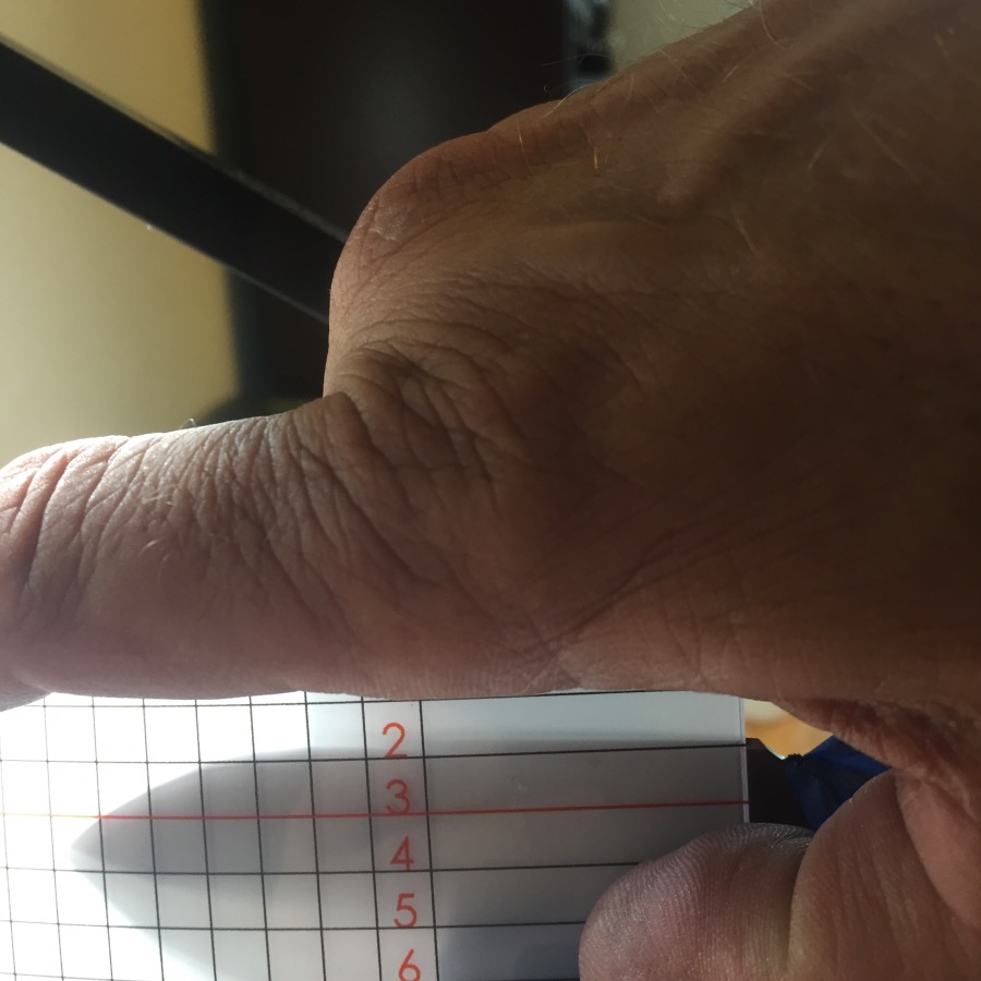

Advanced Alignment Guide - With this tool you can record the alignment of your knife in the clamp even when you need to tilt it to find the right position for sharpening. $8.00

I’m thinking that the single red line on the AAG is 5/8" height above the jaws.
That’s exactly right. The angle settings on the sharpener are calibrated for when the edge of the knife is 5/8" above the top of the jaw. The red line will help you position your knife in the clamp so it is as close to the pre-calibrated settings as possible.

Received my AAG(advanced alignment guide) this weekend but its opaque and need to put light behind it to see a shadow of the knife. Is this normal?
Edit:
its only opaque if your an idiot like me and don’t peal off the protective white film behind it, lol. It’s transparent now!
Hi Joe,
The white paper on the back side of the Advanced Alignment Guide should be peeled off prior to use.
Yes, I’m an idiot. I realized that right after I posted that, lol.
I too missed that it has a backing to peel. Thanks for the post!
does it have to be held against the vise, or do the pins hold it in place?
The pins of the Depth Key should hold it in place.
