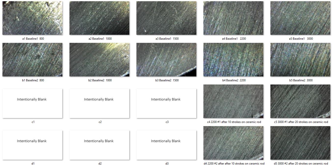

TC, I took your advice and about the glass although I could not find a good piece so I use my white ceramic Messermeister rod (supposedly around 1200 grit but I feel that ceramics don’t follow the scratch grit thing well at all). Anyway, I did another composite below showing 2 rows of Baseline scratch patterns on a cheap knife (800 thru 3000), then I did 10 strokes on the ceramic rod for the 2200 and 20 strokes for the 3000. I did both paddles for consistency. Used medium pressure. I could definitely feel the difference with my finger as well as while sharpening. I did more strokes on the 3000 because my pics at 10 strokes looked and felt like the 3000 needed more (I took over 50 pics). I was also worried about damaging the diamond paddles on the ceramic rod so I started slow but I think I found my sweet spot.
Pictures can be deceiving with lighting and focus challenges under ~200x mag and I tried to use the most typical of my pics without backing into a decision. To me, it seems like both of the Baseline 2200 & 3000 patterns look more like Baseline 800/1000, definitely not 1500. After ceramic rod strokes they are much closer to 1500 but not quite there yet. I am hesitant to do more ceramic rod strokes though so I am just going to use them now after 1000 and before 1500. Maybe after a bunch more knives I will do a scope analysis to see if its time to move them to where they belong. A real PIA BTW.
To me, this shows that break-in is important, complicated when replacing or adding specific grits, not desirable from a marketing standpoint, very inconvenient cause some need more some less, and I still don’t think I am exactly done. Even though I think I have shifted the 2200/3000 grits from around 800/1000 (per Clay) to around 1500, I still use the 1500 after the 2200/3000 for now. I will occasionally do a scope check but it complicates things. I guess I have no choice.
