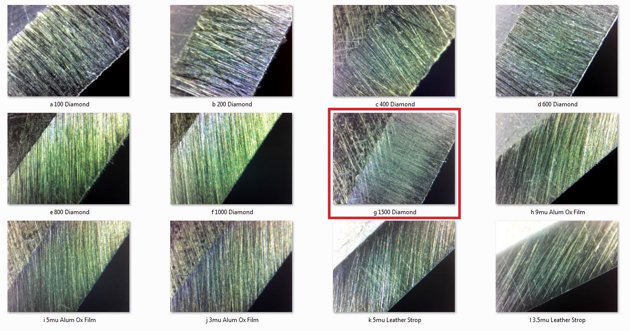

I’ve done about 20 kitchen knives using my 1500 diamonds. It is my favorite. I did a composite a while back with my $35 USB scope. IMO, after 1500 you get into diminishing returns unless you are going for the mirror edge.
Great photos. I too like the new 1500’s
I think the way to tell if your other diamond plates have become too worn is to see if there are any shiny / smooth spots on the surface of the plate. You would expect to see this toward the center of the plate as that is the area that gets the most use.
The new diamond plates definitely cut a great deal faster than when they are worn in. Others have said that they get around 400 knives before the plates are worn out, so I think you’re probably just feeling the difference between a new and old plate.
Great photo’s. Wait a bit until the 1500 is broken in. You’ll be surprised how fine it is and how well it fits after the 1000 grit stone (althought I think it is funde now already).

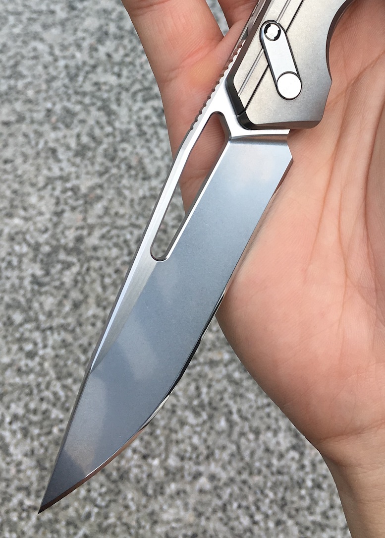

you have a fine looking ticket in this picture…nice job
Awesome polish on that blade!

Nice work! You did a great job at the tip, something I’m still having trouble with. Thanks for sharing.
Oh yes! The tip is in fact where I spent most time on. It’s really difficult to get the tip “perfect” and any roundness shows in the reflection once a mirror finish is achieved.

Which part exactly? If you meant the bevel width, I designed the knife so I know exactly where to sharpen it to get the exact edge I’m after. Then it’s just a lot of elbow grease just to keep the stones from rounding the tip, deliberate sharpening motion and frequent inspections.
