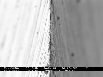

Ok so first concept is along the lines of stuff that has been posted by Science of Sharp in his awesome blog with SEM images:
Down at this level of edge refinement and magnification it has always appeared to me as if the steel is behaving and even looks more like soft clay?
Isnt that what a burr is? Metal that has been pushed or deformed beyond the point where the apex should be, and that edge trailing strokes leave a bigger burr then edge leading, but both methods will develop a burr that “flops” back n forth until it is ripped off or honed off.
The second concept involves vertical scratch patterns and specifically where and how they intersect at the apex leaving a jagged "ridge line"
This is why progressively finer grit abrasives are used to refine this scratch pattern and remove the “tooth”. Finer vertical scratches will leave finer grooves, will leave smaller “scallops” along the apex where the opposite sides intersect.
So my question/theory is…what would happen if you did a sharpening progression laterally along the blade instead of the traditional edge leading/trailing vertical method? Or maybe a better question is what does it look like under a SEM? In my minds eye I can see the clay like scratches formed horizontal and I dont see a ragged ridge line anymore. This pondering all came about as a result of the recent work on the damascus delica:

The way I understand it is that a burr is when metal is rolled away from the apex in only one direction which will effect the cutting ability of the edge. As Todd points out here, a foil or wire edge is different in that it is more typically associated with very thin metal at the apex of the edge (thinner than the preset angle) during the finishing stages.
This is a burr:
This is a wire edge (Todd’s notes: “Cross-section after Chosera 1k with edge trailing strokes. The near-apex bevel angle is 4 degress less than the 16.5 degree spine-defined angle; a foil-edge burr by definition.”)

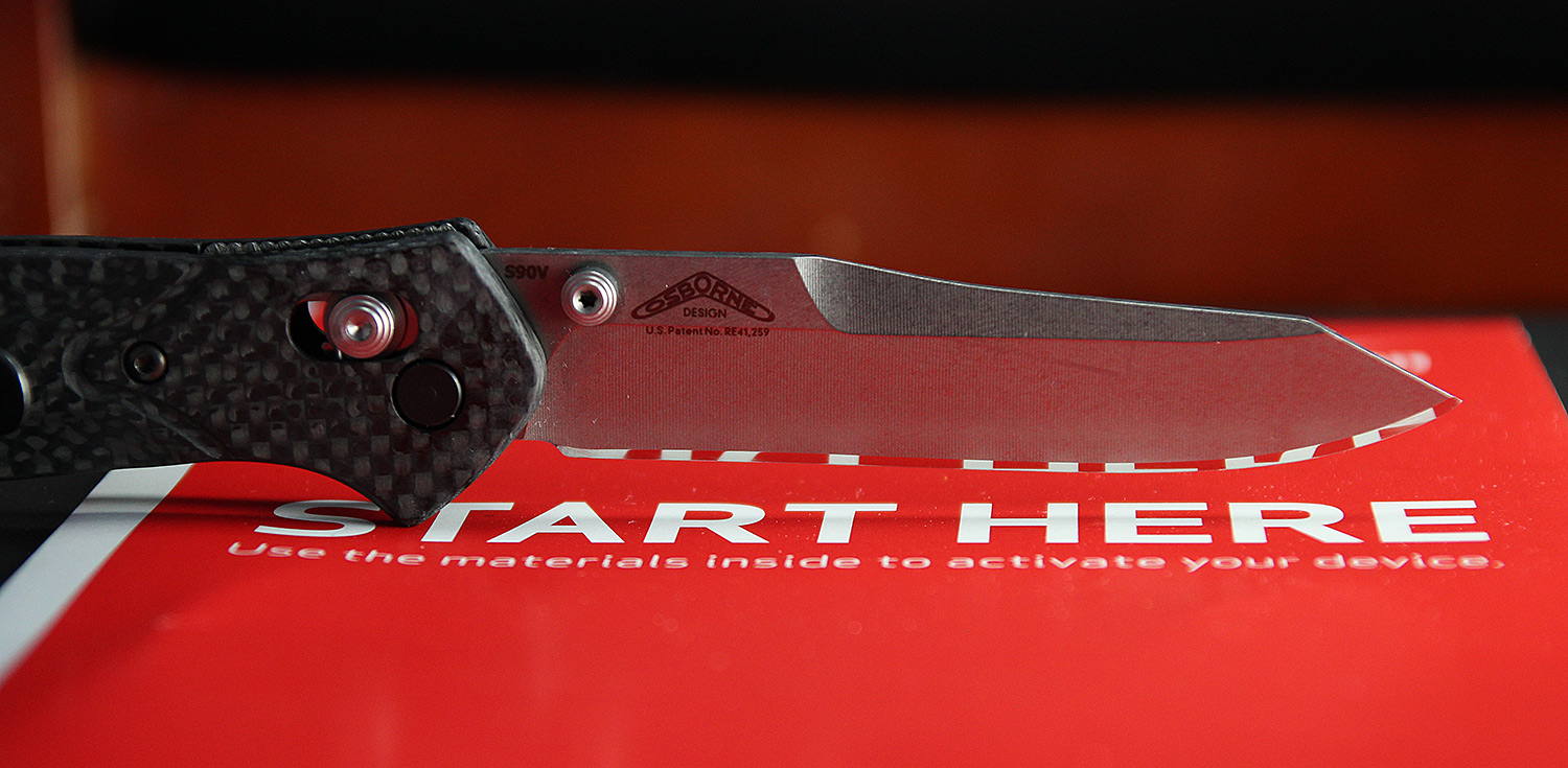

Luckily, a customer had sent in his Benchmade 940-1 for sharpening, so I had something to play with today to test out the technique:
I also added a micro-bevel to get a little tooth on the edge. It’s just barely visible in the last photo.

And I noticed the exact same thing: even with the 200# diamond plates, the edge-parallel strokes produced a really nice polish that was easy to improve upon with each higher grit. I went up through both sets of ceramics and then on to the lapping films. I started with the 1.5µ films and went to the 1.0µ and then to the 0.5µ films. I think it would have been even easier if I’d started with the 6.0µ and progressed downwards.
