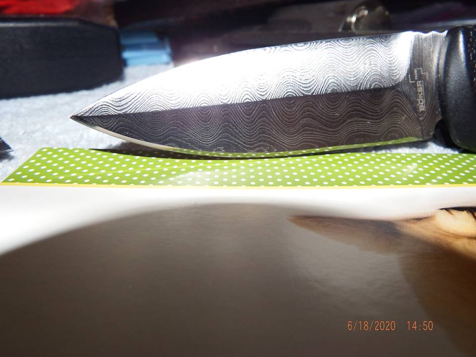

I put a toothy 800 or 1000 grit edge on all of my blades unless I plan on collecting them. I decided to collect my Boker Plus 74 Kalashnikov Damascus Auto, so I put mirrored edges on it as best as I could with what was included in my Pro Pack III.
