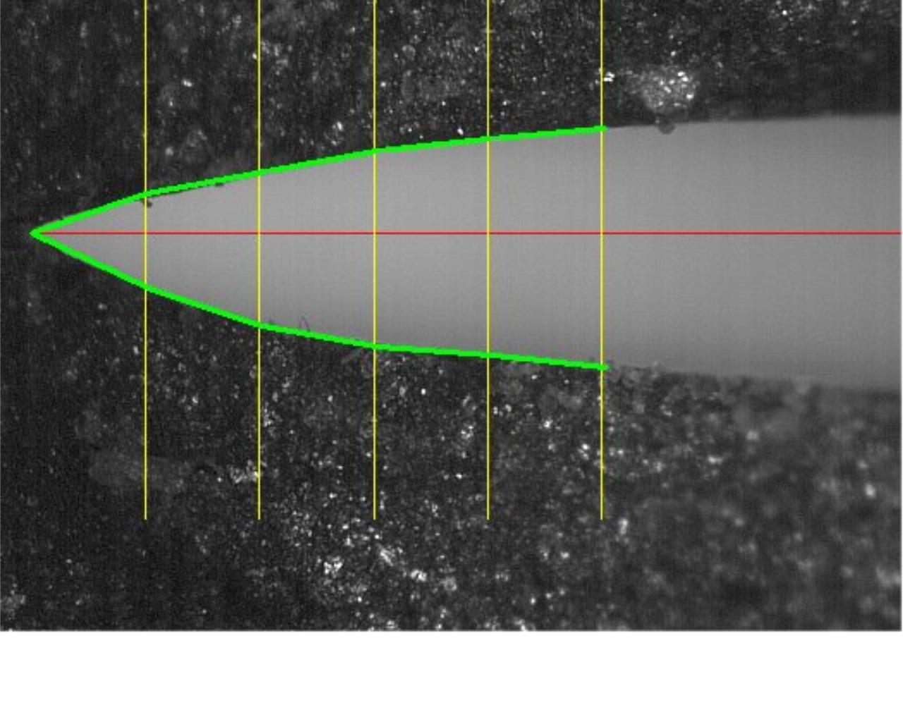

I agree, most of the USB scopes are virtually equal. The only reason why I like Dino-lite is the proprietary software it comes with (DinoCapture 2.0). The software allows you to measure with the USB camera scope very accurately. The cheaper scopes are just a scope and basic imaging software. How would someone use the software for sharpening knives? See the images below of measured and documented edge impressions. WARNING; This isn’t for everyone but is the reason the Dino-lite is so expensive and unique (Proprietary). The optics are also pretty good but I would say not any better than other similar scopes (Overall). One could get away with the cheapest Dino-lite scope and get the great software and measurement tools (See One here).

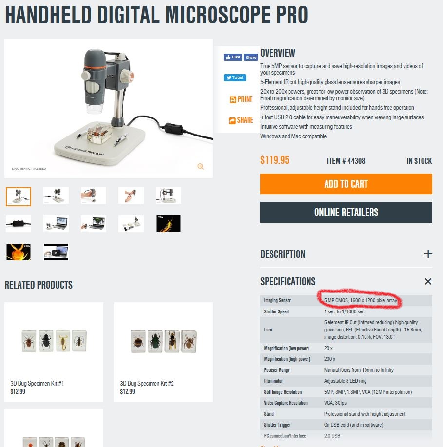

Is the Celestron truly 5MP ? I get mixed answers about whether the pics would be twice the resolution on appropriate monitors. I think the post process image layering would benefit from more MP. Yet the specs from Celestron (attached) indicate a 1600 x 1200 pixel array which is 2MP.

The software is supposed to be pretty good, will work when plugged into my Samsung Note5 phone with a $5 cable, and has a capacitive switch for snapping pictures. I called Celestron about the 5MP having a 1600 x 1200 array (2MP) and couldn’t get a straight answer (waiting for a call back). Also found a ProScope EDU 5MP at $119 which highlighted the 5MP a lot but did not have the array info. There also was not any real reviews nor detailed tech data to find. I called Dino-Lite because I found it very strange that they don’t offer a 5MP until the $1,000 level. Pretty much all of their <$1,000 items have only 1.3MP. I was expecting to hear that the 5MP sensor is much more expensive but I did not hear that. I also expected to hear that their optics and sensor were much better quality but I didn’t hear that either. Their basic answer on why Dino-lite is 10-20x the price was metal housing, 10x-50x optical zoom, software, tech support and the various polarizing type add-ons. As much as I would like to go to the EDOF versions, >$1000 is a bit much just to see what’s happening to my 20 kitchen knives.

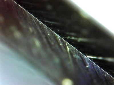

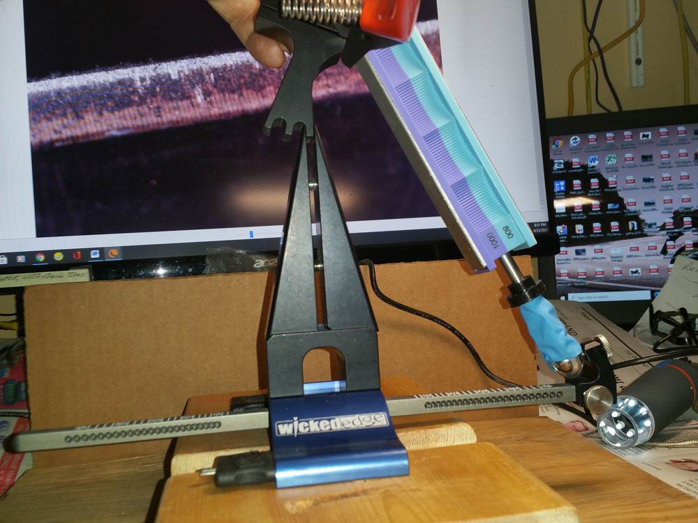

I have used my new Carson and find it a great deal at $37. Software is basic but works fine. Focus knob is full circle and smooth. Pic taking with capacitive button or software. Goose neck holder allows for pretty repeatable viewing between sharpening strokes. It also displays nicely on my laptop and phone. Pics are as clear as I need to see scratch patterns and they stack up nicely for edge views. Attached are some pics of the scope, hi/low mag on PC and phone. Like all these scopes actual mag is function of your display also. These were saved on my laptop (then resized from 100 to 25 in paint to reduce filesize). Best I can tell was that on my laptop screen size the lo mag was ~35x and the hi mag ~150x (~4 times the difference ---- which is what the 75 to 300 scope spec says). With a bigger/better monitor I think I would get closer to the spec. However, what I got was more than enough for scratch pattern patrolling. I will save the home built electron microscope for another time LOL.

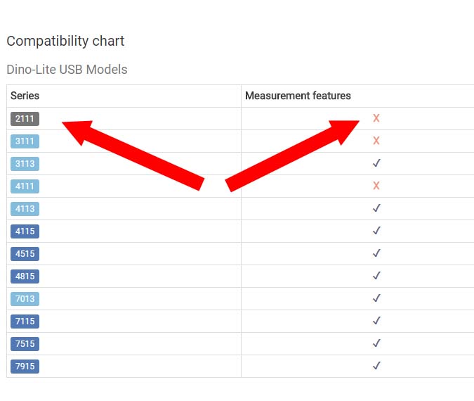

Unfortunately $100 model (AM2111) has measurement toolbar disabled in DinoCapture 2.0. Dino-Lite Basic model AM2111 is crippled. The measurement features are available only in models costing $250 and up. Here is compatibility chart from here
