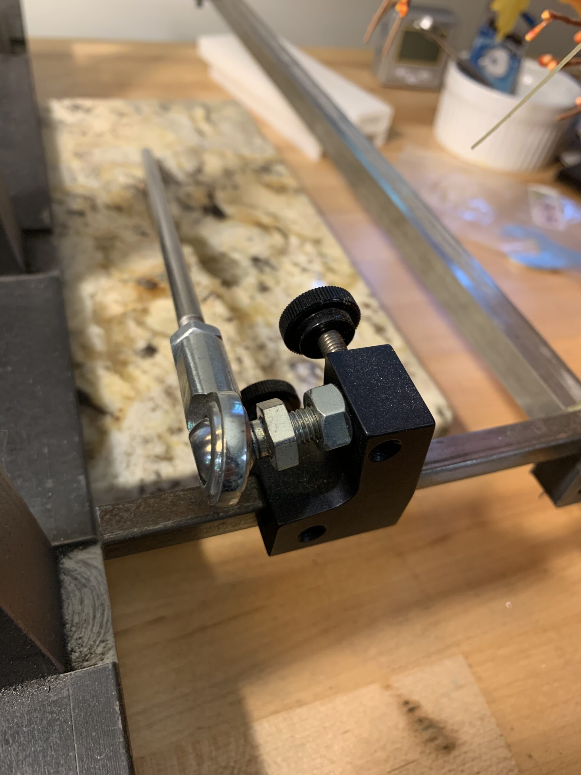

I may be missing something, but a simple solution is to add a nut and tighten it against the hex key.
