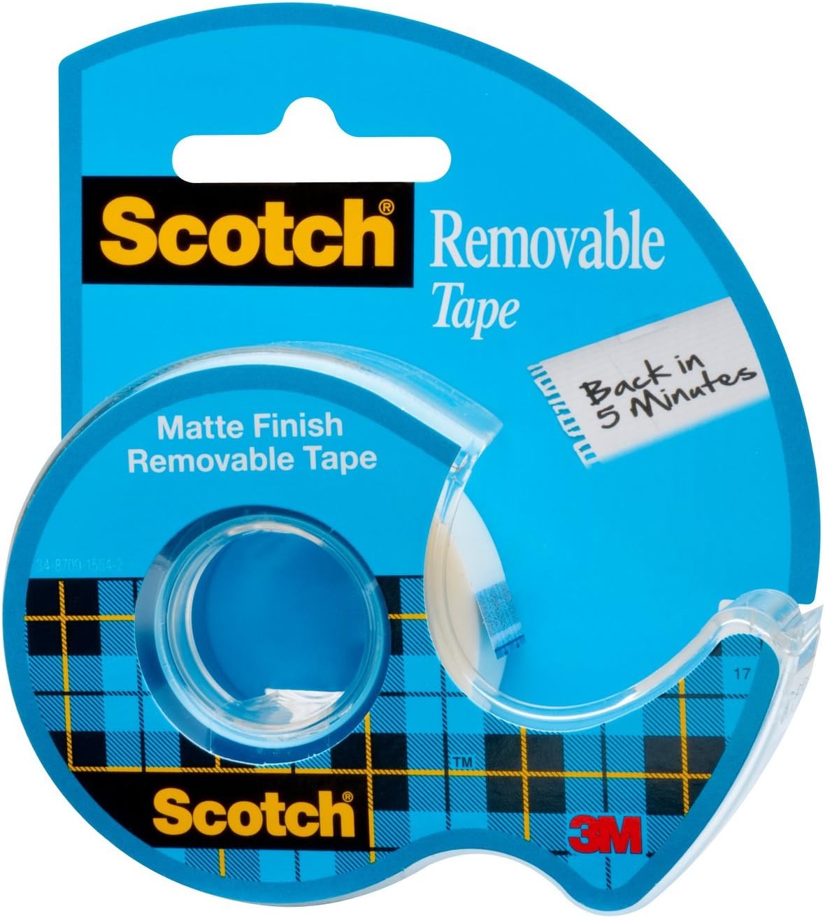

Hmm… Not sure if my previous advice is completely sound. Some materials, such as rubber or heat-shrink tubing actually contract when heated. Since I don’t know what type of plastic goes into straws, I don’t know how they would respond to heat.
If the straw is too thick, and the paddle wont slide on it, then you might try something thinner. One possiblity is clear-tape. Clear tape usually has a fairly smooth and slippery surface. You could stick a line of tape to the rod, and see if that works. Probably, clear tape is thinner than a McDonalds’ straw.
The only downside is that the tape could leave a glue residue if you needed to remove/replace it. To remove the residue, you could use a solvent such as acetone. btw, do not use solvent on the paddles at all; acetone can soften or dissolve plastic. However, it should be just fine to use solvent on the metal rods.
If you don’t want to use solvent, you can use new clear-tape and repeated stick new tape on and peel it off; the old glue on the rod will stick at least partially to the new tape, and will peel off with it. At least, a little bit will peel off each time, so you need to do it repeatedly. This is an old trick my mother taught me for removing residual glue left from stickers on jars.
There is such a thing as Removable Scotch Tape. I suppose you could try that if you’re concerned about the glue residue. It may not be as thick or smooth as clear-tape, so probably should experiment with it first.
Anyways, just my random thoughts about it. If you try any of these, or other ideas, let us know how it goes.
