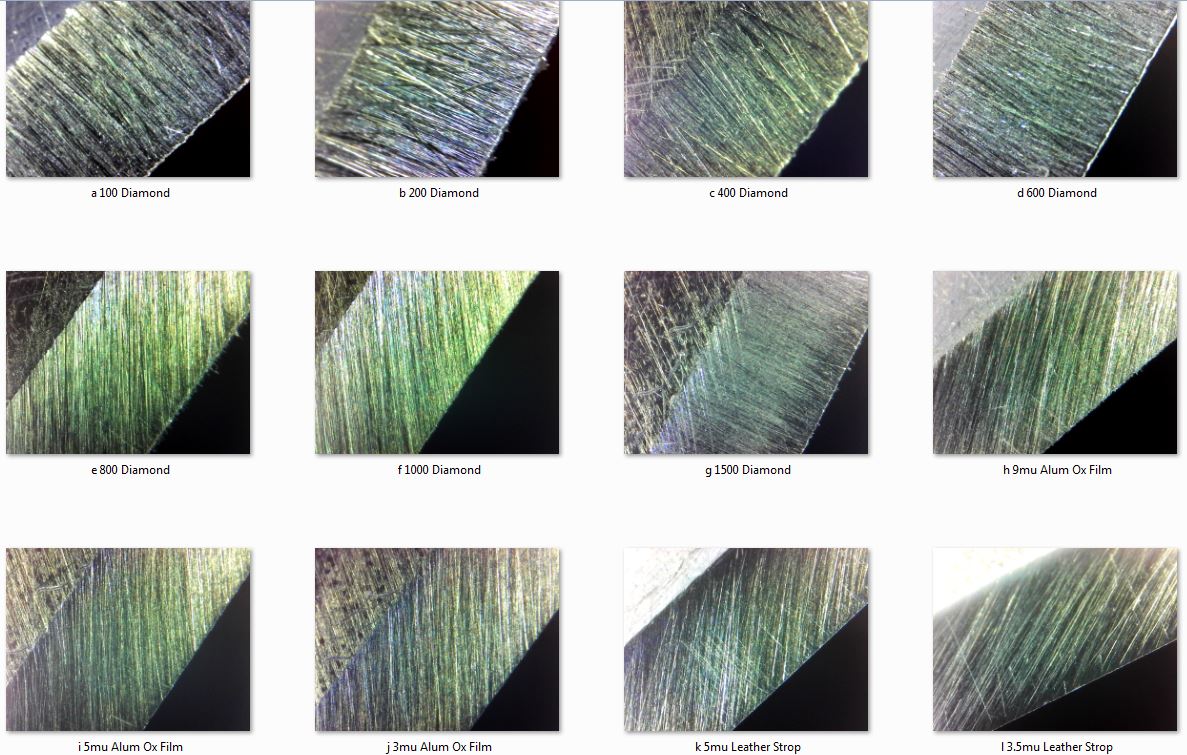

Sounds like you have a solid approach and know what you are doing. IMO, rogue scratches are very difficult, time consuming and quite possibly impossible to avoid unless you take many hours in a super clean total environment. Our diamond stones et al. are not at the lapping and polishing quality level. I stopped driving myself nuts with “where did that come from”. It is, however, occasionally self satisfying to do a science project for a few hours on a single knife. It could also be argued that reasonable cleanliness techniques could minimize the rogue scratches. The pics below are under ~250X.
