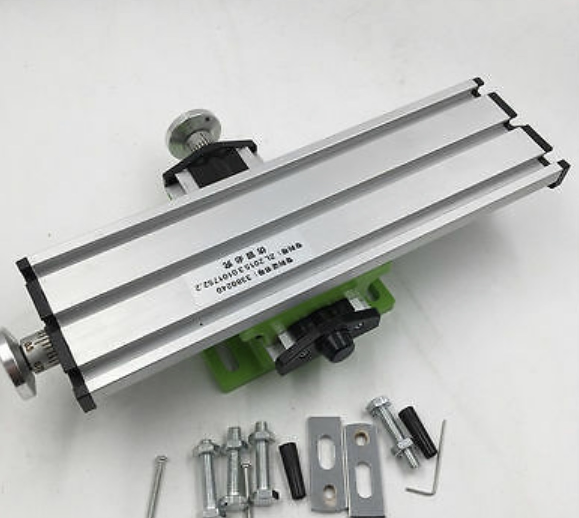

I don’t think it is doable because of the basic design of the Wickededge. The paddles pivot at a point. For serrations you grind vertical concavities in the blade.
If you really want to do it I think you could mount your vise on an x-y table and mount your rod on the work table. You would have your rod pivot in one plane only.
Next, as you pointed out, you would need cylindrical stones to slide on the rods.
Another advantage of mounting the vise on an x-y table is that it would make sharpening long blades easier. You can move the blade/vise to get to the part of the blade that is out of reach.
Although mounting your back rod would be a bit tricky.

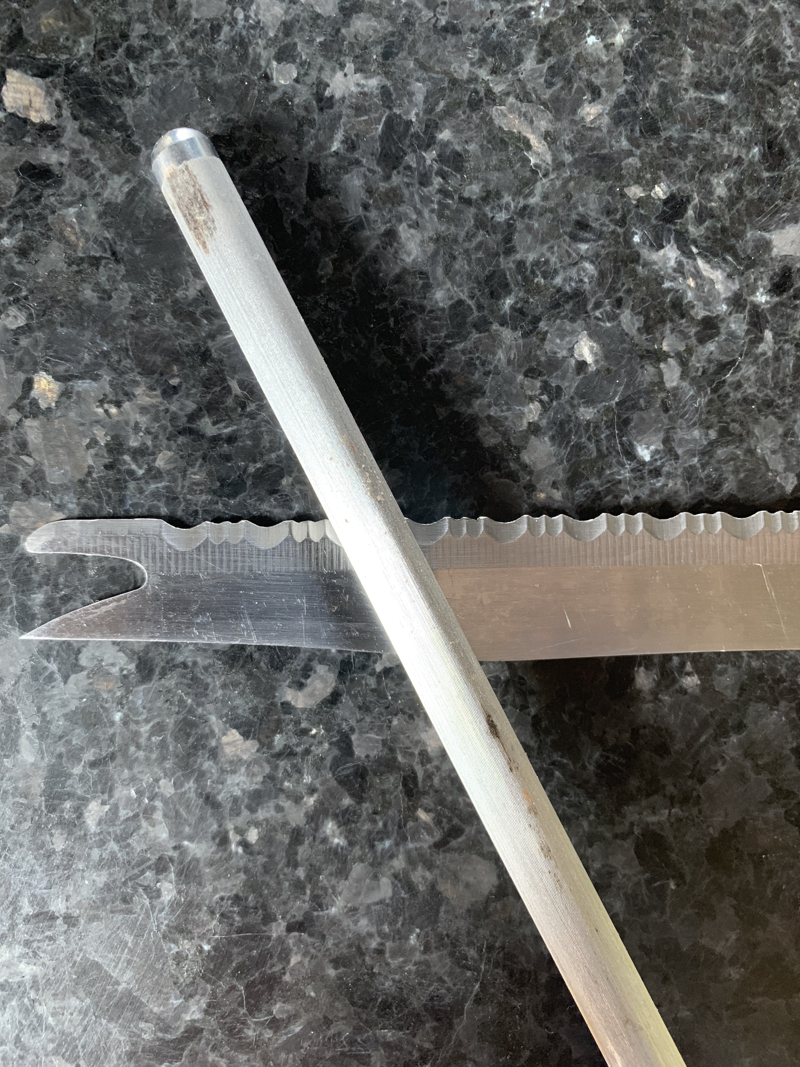

It’s quite a challenge. It’s limtless how many serrated knife edges there are:
Challenges for sure, but all you need is a simple (cheap) adjustable step linear indexer which holds the knife and mounts in the clamp. For the rods — yeah there are many but most are arcs or flat angles and off the shelf ceramics cover maybe 80% of them. Diamond rods are probably out of the question. Diamond film on the other hand can be stuck to the ceramic rod. We basically reprofile straight edges with WEPS the first time thru anyway.
