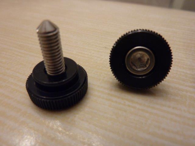

Does anyone know where I could get some hex head thumbscrews to replace the original thumbscrews that lock the arms on the angle bar? I’d like to be able to lock them down tighter. I’ve seen this modification on a few youtube videos, even went to Lowes to try and source some 5/32 hex head bolts that would fit, but the threads seemed off and it would not work.

Call WE and they will send them. I did for both the bar screws and fine adjust.
I use the hex head screws to lock to the bar. The original ones I could not get tight enough by hand and they kept coming loose.
For the set screws that lock the fine adjust on the upgrade arms I got the screws with the plastic tips to protect the treads on the fine adjust arms.

BTW: these are 10-32 thread, (not 5-32, like the post above stated)

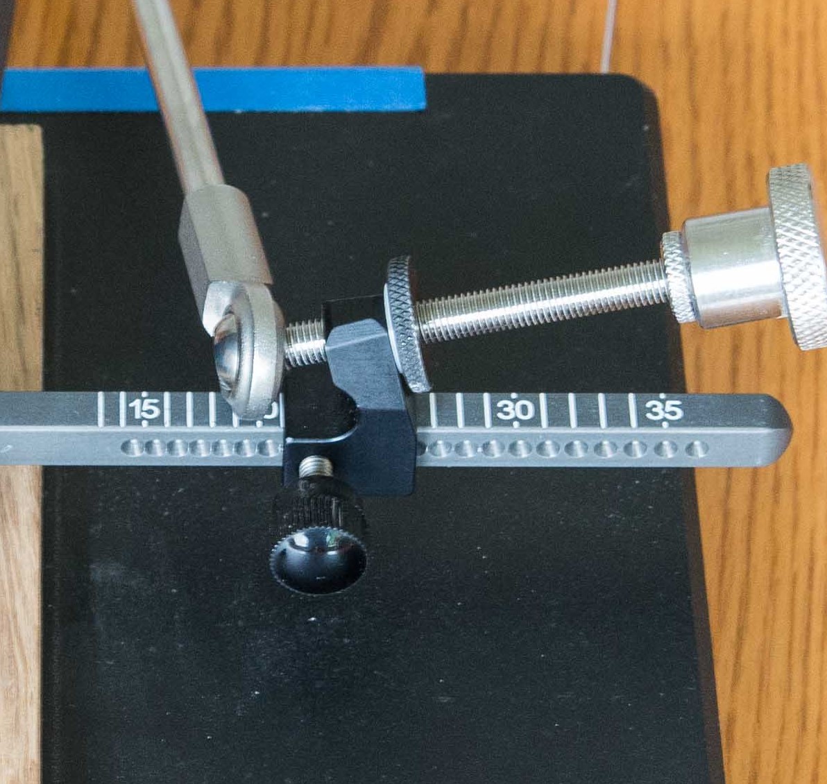

If this is what the question is asking about, this is what I did to be able to tighten the L-Brackets on the degree bar.
I replaced the thumbscrews on the L-brackets with plastic 9/16” knurled knobs from MSC Industrial Supply (part # 06172308) that come with female metal inserts that are threaded to #10/32, the same threading as the L-brackets. Next I had the heads removed from one inch #10/32 socket-head cap screws, and had points machined onto the ends of the cap screws at 45 degrees to match the points on the original thumbscrews. Finally I screwed the cap screws into the plastic knobs with a little epoxy to make sure they stayed put.
These thumbscrews never loosen up on me.
