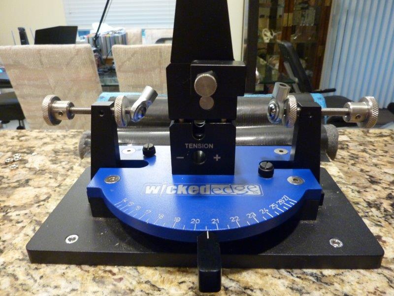

Guten tag Thomas and welcome to the forum! I lived in the Rheinland-Pfalz from 2008-2011, what a beautiful part of the world you are from. Are you near Karlsruhe? The one point I wanted to make about the Gen 3 is that it sits a little high because of the base included for stone storage. I took that into consideration when I purchased mine and now I am thinking about removing it from the base because of the height of the workbench I use it on. Currently, I have to stand up when sharpening and let me tell you, that gets real old after a few hours. Other than that one issue, it’s been a solid performer with the cam-lock vice. One thing that I discovered when I first started using it was that the set screws that secure the micro-adjustment tend to back out once I began sharpening so I started tightening both of them (not much) with a set of small channel locks and haven’t had that issue since. Good luck and don’t hesitate to use this forum for answers and advice.
Removing the Gen 3 Pro base shelf is easily accomplished. Here is a picture of how it looks mounted flat down on the W.E. granite base:
I added these micro-angle adjustment modifications to eliminate the issue with the lock knobs coming loose:
The modifications set-ups I pick-up from forum member “notsharpenuff”. He makes these as a hobby and shares them for pretty much what he has in them in his parts expenses. He follows the design concept previously shared on this forum and utilized by TCMeyer.
