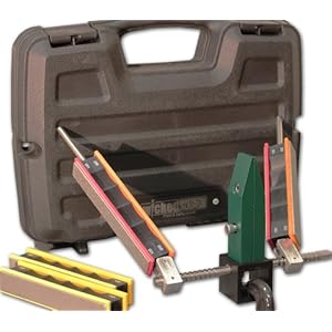

Guys, can anyone tell me what it is this set here on Amazon:
http://www.amazon.com/Wicked-Edge-Field-and-Sport/dp/B006WRH5JO/ref=sr_1_6?ie=UTF8&qid=1339747114&sr=8-6
[quote quote=“TarasShevchenko” post=3436]Guys, can anyone tell me what it is this set here on Amazon:
http://www.amazon.com/Wicked-Edge-Field-and-Sport/dp/B006WRH5JO/ref=sr_1_6?ie=UTF8&qid=1339747114&sr=8-6[/quote]
It’s pretty much just what you see there - the Carrying Case, C-Clamp, Riser, Vise Jaws, Base Rod, Swivel Joints and Arms and the stones 100#, 200#, 400# and 600#. It’s the new Field & Sport model we’re releasing.
So this is a new model, I have not seen it on your website and thought it was some model from while back.
Looks very interesting because as far as I understand it eliminates the need for the base? You just clamp it to the table, am I right?
[quote quote=“TarasShevchenko” post=3438]So this is a new model, I have not seen it on your website and thought it was some model from while back.
Looks very interesting because as far as I understand it eliminates the need for the base? You just clamp it to the table, am I right?[/quote]
Yes, you can just clamp it to a table or anything solid. It’s nice and light and portable.
