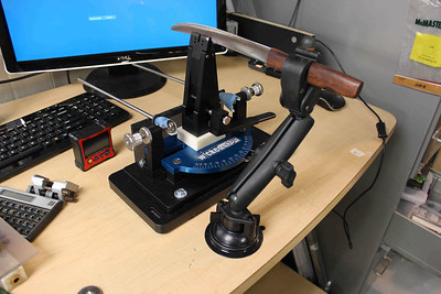

There are two ways to tackle this issue. Both require a little mechanical ingenuity.
  • You can wrap something around or apply something to the knife blade where it's positioned and clamped in the vise jaws. Some W.E. users apply tape like blue painters tape or silver aluminum foil tape to the blade. The tape stays in place on the knife steel while it provides for some compression by the jaws into the tape. I like to use a small patch of real leather chamois cloth. (Used to dry cars). I fold it around the knife blade where it's clamped in the vise jaws. The chamois is pretty thick and compresses well. This works well, for me while also providing protection from scratching to the knife steel.
  • Another plan of attack is to support the handle with something so the knife can't swivel in the jaws. Some W.E. users have purchased "Ram Mount" parts to make an accessory or modification that can be moved or swiveled to a variety of positions. (There are all sorts of RAM parts available). Another option is a mini telescopic pole. This looks like it can be modified and adjusted to the length needed to support the knife handle. The simplest support is a small piece of wood cut to the length you need.

Thank you Marc. I’ll give the ram mount a go as it looks like it would work.
I was thinking about using a metal rod with a “holder” on it. But the Ram thing looks more elegant to what I was planing.
Panavise makes some practical options like the Panavise Jr model PV 209.
And
https://www.rammount.com/components
Sometimes you need to support the handle and other times the blade end. You may be able to marry the two products to create a versatile accessory.
