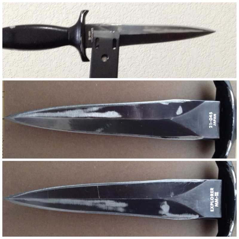

Can you clamp it near the heel/handle like this?
(Probably want to tape yours first…)
(From this thread)… Old Gerber dagger – Wicked Edge Precision Knife Sharpener
Just angle it up so the edge is approximately parallel to the top of the clamp.
p.s. Ignore all the grinding on my example…it was a beater knife. :slight_smile:
