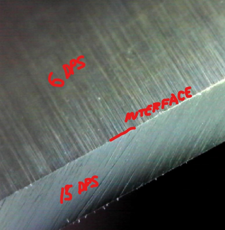

Personally, I do not lower the angle for stropping. I am pretty sure that folks do this to avoid rolling the edge due to too much pressure. However, a very light touch does not roll the edge. I like to think that I am stropping the entire primary bevel (magnified photos show an amazing amount of burnishing with pasted up strops) and if you reduce the angle I have no confidence that the entire primary bevel is being burnished. I trust the WEPS to stay on the primary bevel from initial 100 grit thru the strops. I have experimented with using some of the highest grits including diamond films and strops to smooth the interface of the primary bevel (say 15 DPS) with the main face bevel (say 6 DPS) but I have not done a lot of it. Attached is one of my latest edges without changing the strop angle. I would smooth the interface if I still had the knife but I gave it back to my dentist. The edge scalloped shiny newsprint like butter and I would be interested if it did better. Maybe on my next kitchen knife.

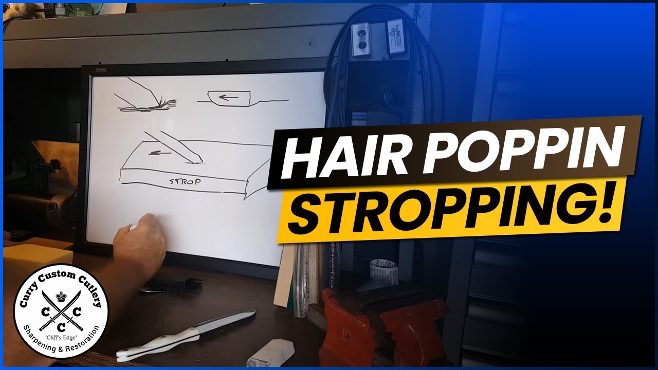

I like to recommend newbies watch this video. It explains the issue with stropping and rounding off the edge well. The producer is a long time W.E. user:
