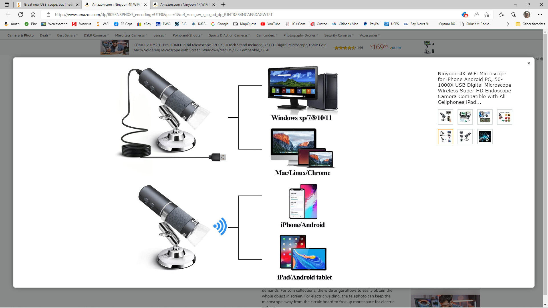

Based on the scope’s product descriptions and my experience with this type of scope it connects via wifi direct to tablets or smart phones. Not through a home network/router. Only wired via USB to computers.

Yup, that’s why I assumed it would work with my PC. Even in the instructions (which are printed so small I needed the microscope to read it) it implies that it should work with Windows XP, 7, 8, 10 and 11, which to me means PC compatible. Maybe the caveat is that it’s WiFi with smart phone and USB with PCs. I don’t think it says specifically that WiFi won’t work with PCs. Or I’m too old/dumb to figure it out.
Bingo! I now remember seeing that diagram when I ordered it, but it had been a while when I finally got around to starting it up and there was nothing like it in the instructions. Thanks for the help, guys!
Ok, got mine yesterday and it makes sense now. So it works the same way as others where the USB cable connects to the desktop or laptop computer and then you use a viewer like Plugable Digital Viewer (www.plugable.com) to display the images.
Now on your phone, the instructions have a QR code for the website where you can find the ‘WiFi Check’ app or you can go to www.ninyoon.com/art/4k to download it. Install it on your phone and disconnect the USB cable. Open up your ‘Settings’ folder (I have an iPhone) and take note of what’s in your ‘My Networks’ sub-folder. Turn on your microscope and it will generate a WiFi signal and appear in your ‘My Networks’, mine is named ‘HD-Microscope-b7a8’. Tap that network and after a second or two, you’ll see your home network swap roles with the microscope and become your connected network located in your ‘Wi-Fi’ subfolder. Open up the ‘WiFi Check’ app on your phone, answer any questions if it asks (mine didn’t) and view the images.
