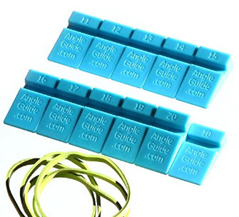

I would say +/- 0.5 degrees. You can use angle guide reference point like those at AngleGuide.com. Human muscle memory is actually very good if you use reference point.
I agree, cool product.!

I would say +/- 0.5 degrees. You can use angle guide reference point like those at AngleGuide.com. Human muscle memory is actually very good if you use reference point. [/quote]
I agree that muscle memory is very reliable, once learned. But, technically, that’s a guided sharpening system you’ve got pictured there… :slight_smile: That would be a very good learning tool for freehand sharpening, but if you take away the guide and sharpen from muscle memory without a reference point, I’m 100% positive you will get more than +/- 0.5 degrees in variation.

[quote quote=38089]
AngleGuide-Blue-Amazon AngleGuide-Blue-On-Stone-Amazon [/quote]
Yeah, nice product. So simple I'm thinking how come no one has ever come up with it before?
