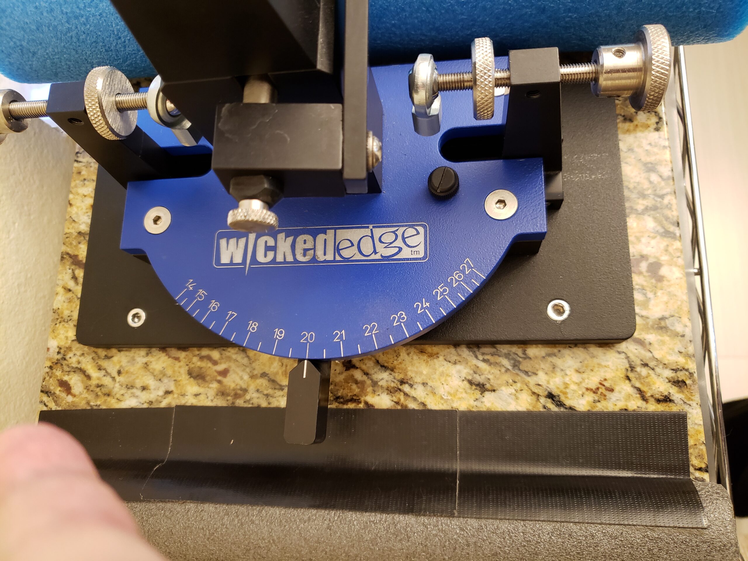

I have my Gen 3 Pro model mounted directly on a granite base with out shelf unit. It simply unscrews. That’s an option if you want to keep the Gen 3 Pro model with it’s single lever that adjust both side’s angles simultaneously.
You may find a piece of granite cheaper, cut at a local shop, if you check around your area. It just needs a couple mounting holes drilled in it and and rubber bumpers stuck to the bottom. It’s smaller than the piece they’d cut out of a kitchen counter to make the a large sink’s mounting hole.

I purchase my Gen 3 Pro with the granite base directly from W.E.. The granite base was drilled with four mounting holes. You can see two of the screws in the front corners of the Gen 3 Pro’s black base plate.
I’d think that any local stone shop that could cut and and polish the granite could also drill the mounting holes. Just take with you the Gen 3 Pro, removed from the shelf base, or a template which you could easily draw up.

There are micro-angle adjusters available for the both the Gen 3 Pro and the WE130 models. I have the adjusters on my Gen 3 Pro, pictured above.
