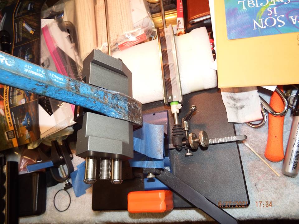

I would recommend the 50/80 stones for reprofiling blades and chisels, but you have to be careful with them. I would also recommend the 1500/2200 and the 3000/glass platen stones and some lapping films. I also recommend some leather stropping handles with diamond sprays. But as Marc said, it really depends on your needs and wants.
I also recommend the Chisel and Scissors attachments if you plan to reprofile/sharpen chisels and scissors. My chisels and scissors are sharper than most peoples knives. lol
here’s a photo of me reprofiling/sharpening one of my dads big old cold chisels:
