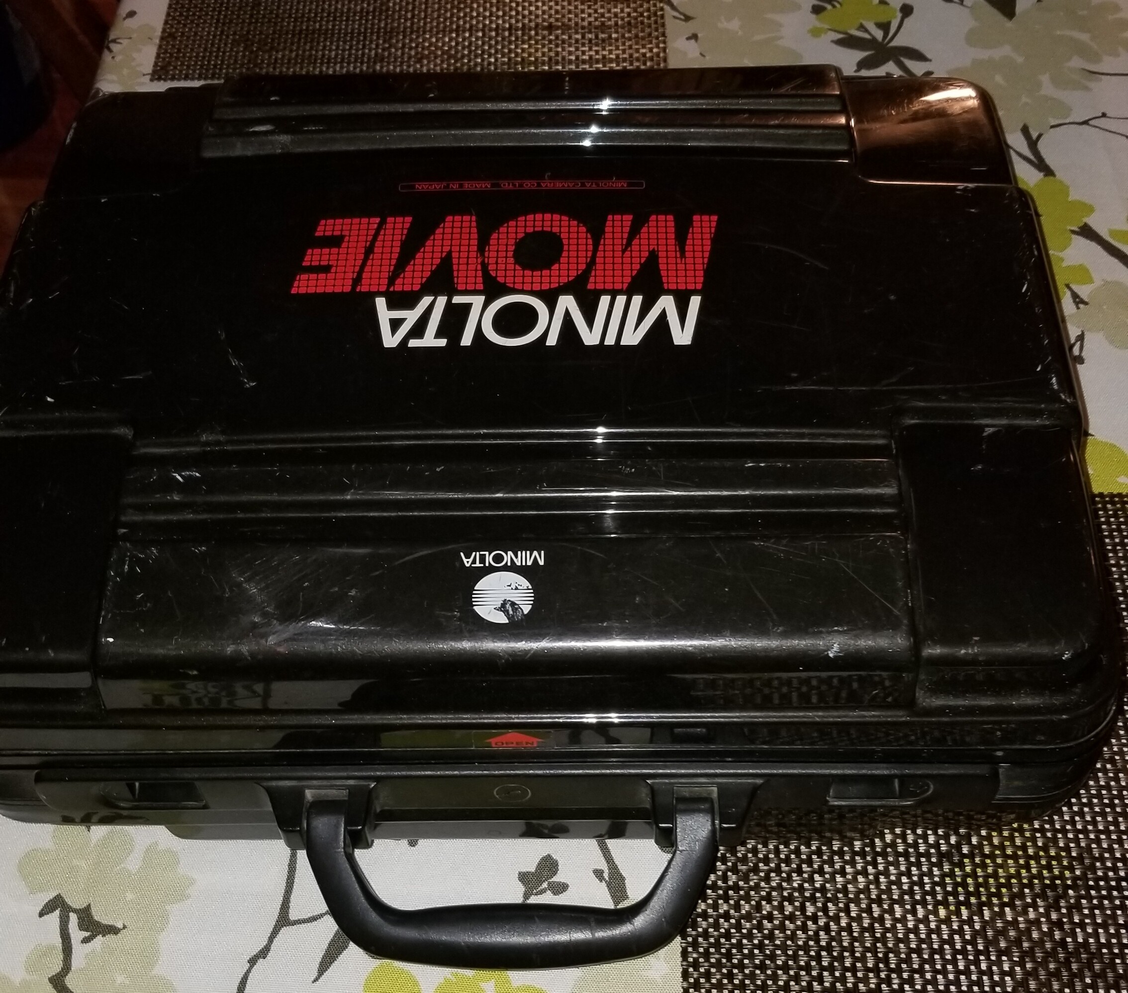

You are where I was with the knife guards. I only do kitchen knives and many are quite flexible. I found the guards were too bulky, not stiff and too low. Those stiff heavy tees fit nicely in the clamp. I wanted wider ones for full coverage but that’s all I could find. I found someone who would machine 6" wide jaws for a clean look but I didn’t want to spend $500. Good luck and keep the ideas flowing. Unfortunately, this forum has turned into just a welcome mat. Maybe Web 3.0 will help. Anyway, here is a pic of my case circa. 1989 with a second post showing the inside. If only we could brainstorm serrated knives but I hate typing on my phone. I do have ideas though. Let’s go NY Jets…LOL
Inside, all hand cut from foam which came from my sons gift of Iberico Jamon from Spaim
