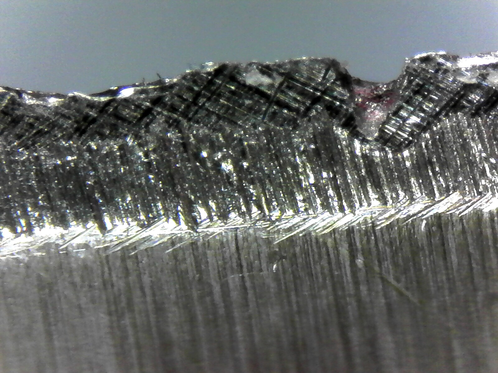

Couple of scope pics before and after.. not stropped (Steak knife)
