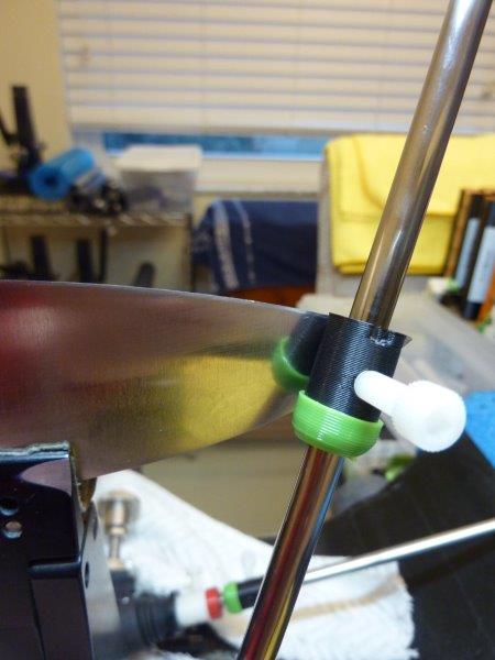

Thanks again, Anthony! This proof absolutely rulez because of its simplicity. And what I also like is that you approach it with linear algebra. I really thought it would take geometry, which probably would have made it much more complex.
So, a quick check, or for the “Field & Sport” model that doesn’t have the guide setup, would be to take a quick measurement to insure the tip is approx. the same distance from the pivot as the straight part of the blade.
p.s. The ruler is just for the photo, you could use the stone itself… make a mark, or just make sure it hits approx. the same spot.

Lee, I’ll try to explain the method I use to help me position a knife with a belly or a curve in the knife’s edge. I am using a WE130.
It does take some sliding and repositioning the knife forward and backwards in the vise jaws while also rotating the knife so it’s tip up or knife tip down when clamped tight in the vise. The knife doesn’t need to be resting on the depth key pins as long as you can use the depth key to position your alignment guide or advanced alignment guide to record the clamping position in your sharpening log.
I’m looking to find a balanced clamping position where the same height position I mark on the guide rod meets the knife edge on either end of the knife edge’s belly or curve. I use a stone stop to align with the knife edge’s height because the stop is easy to move up and down as I attempt to find the best clamping position. I could just as easily use a piece of masking tape stuck in place on the guide rod so it’s positioned even with the knife edge. The tape is easily moved up and down just like the stone stop to allow me to zero in on the best clamping position.
This is a method that begins with trial and error until you gain some experience positioning and clamping a variety of knives of different shapes. Then with time you’ll look at a knife and inherently know where to best position the knife to start with. Then with only minor tweaks you’ll be dead-on right where it needs to be.
Here I have my upper stone stop slid down on the guide rod to where the knife edge of the belly at the knife tip is aligned with top of the stone stop and the stop is locked in positioned on the guide rod.
Then I rotate the guide rod back towards the knife’s center so the top of the same locked stone top is still positioned and aligned with the knife’s edge at the belly near the center of the knife.
The first time I sharpen any knife with the W.E., a small amount of steel may be sacrificed and removed at the knife ends as the knife is profiled to the Wicked Edge fixed angle sharpening system. If you choose your clamping position well this steel loss my be almost none. If you record the sharpening position well, in your sharpening log book, with subsequent touch-ups as long as the knife is positioned just the same, no further edge profiling and steel sacrificing is necessary. The knife will match perfectly with that original position determined and used when that knife was first sharpened.
The knife’s clamping position and the bevel angles are two separate things, though they are related.
This method, I described above, is to determine the “best” or most efficient clamping position to use when sharpening a knife. This is called the “sweet spot”. The sweet spot in turn allows us to find or determine the existing bevel angles in order to sharpen the knife well, while maintaining the existing bevel angles. When the knife is clamped in it’s “sweet spot” the sharpening stones should contact the knife edge well, down the entire length of the knife. This is strictly about efficient knife placement for clamping.
You can narrow down or fine tune the “sweet spot” clamping position when combined with the sharpie method. By applying a sharpie then observing where the sharpie ink is removed from the knife bevels using fine grit stones, you can re-position the knife shifting it ever so slightly so where the stones contact the bevels are consistent positions along the bevels, and across the entire length of the knife.
The determination of the bevel angles is another, more specific, process. This is done after the “sweet spot” clamping position is first determined.
With the knife clamped in the vise jaws in it’s “sweet spot” position, using the sharpie method we can observe and match when the sharpie’s ink is being removed. While repeatedly applying and reapplying the sharpie ink, while making angle and micro-angle adjustments we find when the ink is best removed from the entire bevel while running a fine grit sharpening stone with very lightly applied pressure, across the bevels. We are simply trying to remove the ink, not any steel. It is a give and take situation. We’re simply looking for the angle setting(s) that coincides with when the ink was removed most completely from the entire knife edge.
When this best postion is found then measured with your properly zeroed angle cube it broadly indicates the existing bevel angles of that clamped knife’s edge. Depending on how well the knife was made, or how well the knife was last sharpened will be shown by how well you can adjust the guide rod angles so the stones match along the entire knife length. Seldom do we find that the bevel angles are consistent from knife side to side or even down the length on just one knife side. That is unless the knife was last sharpened well using a Wicked Edge Sharpener or it was precision machine sharpened from the knife’s maker.
We are trying to find the angle setting that allows for the most efficient removal of the sharpie ink, on average. With that observed and measured angle we can then choose an angle setting that will allow us to best sharpen the knife to the angle of our choice that is best for our needs and applications.
Even if you decide to re-profile the knife to a different angle, one of your choosing from the outset, you should still determine the “sweet spot” first, in order to sharpen the knife well and efficiently with the least amount of steel lost or wasted.
