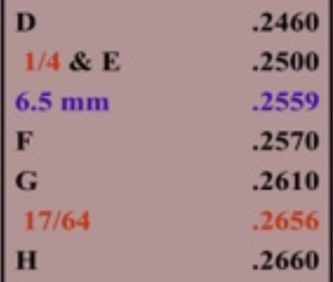

If you want slightly larger than .25" and don’t mind a steel that might rust you can order drill rod in metric or letter sizes.

Expedia, I haven’t looked but I don’t know if you can find stainless with a diameter of .257", although I think tcmeyer may have, judging from an earlier post.
