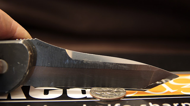

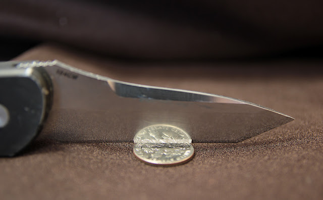

I took a little time to sharpen a knife today and create the kind of edge I described above - highly polished, convex bevel with a semi-toothy micro-bevel. I chose my Benchmade 9500 Mini Stryker for the project, which I had previously sharpened to 15 degrees per side. I had used the knife very little, if at all with narrow bevel and when I inspected it, I discovered that the edge was damaged, which wasn’t too surprising since the steel is CPM154. Here are some images of the edge at 15 degrees per side before I went back to work on it:
The above images are taken at 510x magnification.
Next I created a nice convex bevel, spanning from 16-20 degrees with the usual method of creating micro-bevels and then strops. The work was easy since the edge had already been relieved down to 15 degrees. I opted to just use the 800 through 1600 grit stones and then the following progression of strops: 14µ> 10µ> 5µ> 3.5µ> 1µ> .5µ
Here is a shot of the convex bevel at 510x and .5µ polish:
Next I created the micro-bevel at 20 degrees per side with the 1600 grit ceramic stones:
For the above image, I adjusted the focus to highlight the edge.
In the image above, I focused on the shoulder to show the transition from polished bevel to toothy micro-bevel.
The following images are some shots with a regular camera:
