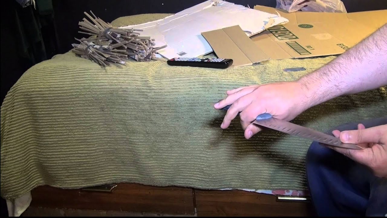

This is how I do it ?
https://youtu.be/_eNKG5EMWlM
Thanks for reposting the video Josh. The first time I did it was for a full flat ground blade. To double check that the math made sense I laid the blade on my countertop and measured the angle of the blade from the counter top. Long story short the angle of the blade checked out with the measurements in the vice which was good to know before I stared grinding away.

One thing just pointed out to me is that I had my math wrong in the video… someone pointed this out to me about a year or two ago and I edited the video with a caption to correct the math. So if you have a browser w/ an add on that disables the captions you will miss it. Just wanted to note this! Thanks and glad it’s helping.
Actually, Josh has two math errors in the video. He subtracted the left reading (+0.70) from the right (-4.00) when he should have added them. The object is to find the angular displacement between one side of the blade and the other. Imagine that you have the AngleCube on the left side, reading +0.70. Now rotate the 'cube to the left to -4.00. To do so, you have to rotate the 'cube 4.70 degrees, not 3.30. This means the median (centerline) is displaced 2.35 degrees from each face. If the blade were perfectly vertical, it would read +2.35 on the left side and -2.35 on the right side. Since the left side reads +0.70 instead of +2.35, the centerline is canted 1.65 degrees to the left. To compensate, you deduct 1.65 from the left setting and add 1.65 to the right.

So, is it just a coincidence that you get the same result of 1.65 if you take 4-.7=3.3/2=1.65 vs what you posted here? 4+.7=4.7/2=2.35-.7=1.65
Yup.

The object of my method is to find the displacement between the two faces so that you know what the centerline is, so you can calculate the amount of cant/lean. In your video, you measured 3.3 degrees, with what you thought was a centerline of 1.65 degrees. The real centerline is 2.35 degrees (4.7 / 2). While your method ends up with the correct offset, for this clamping instance, you can’t use that centerline again when you remount the blade.
For example, if the next time you mount the blade, you measure +1.30 degrees on the left and you subtract that from your old 1.65 centerline, you’ll deduct 0.35 degrees (1.65 - 1.30) from your left rod setting when you should deduct 1.05 degrees (2.35 - 1.30). Your bevels will be off by 0.70 degrees.
So long as you use your complete procedure, you’ll be OK, but you’ll have an incorrect value for the primary grind angles, because your formula is convoluted.
