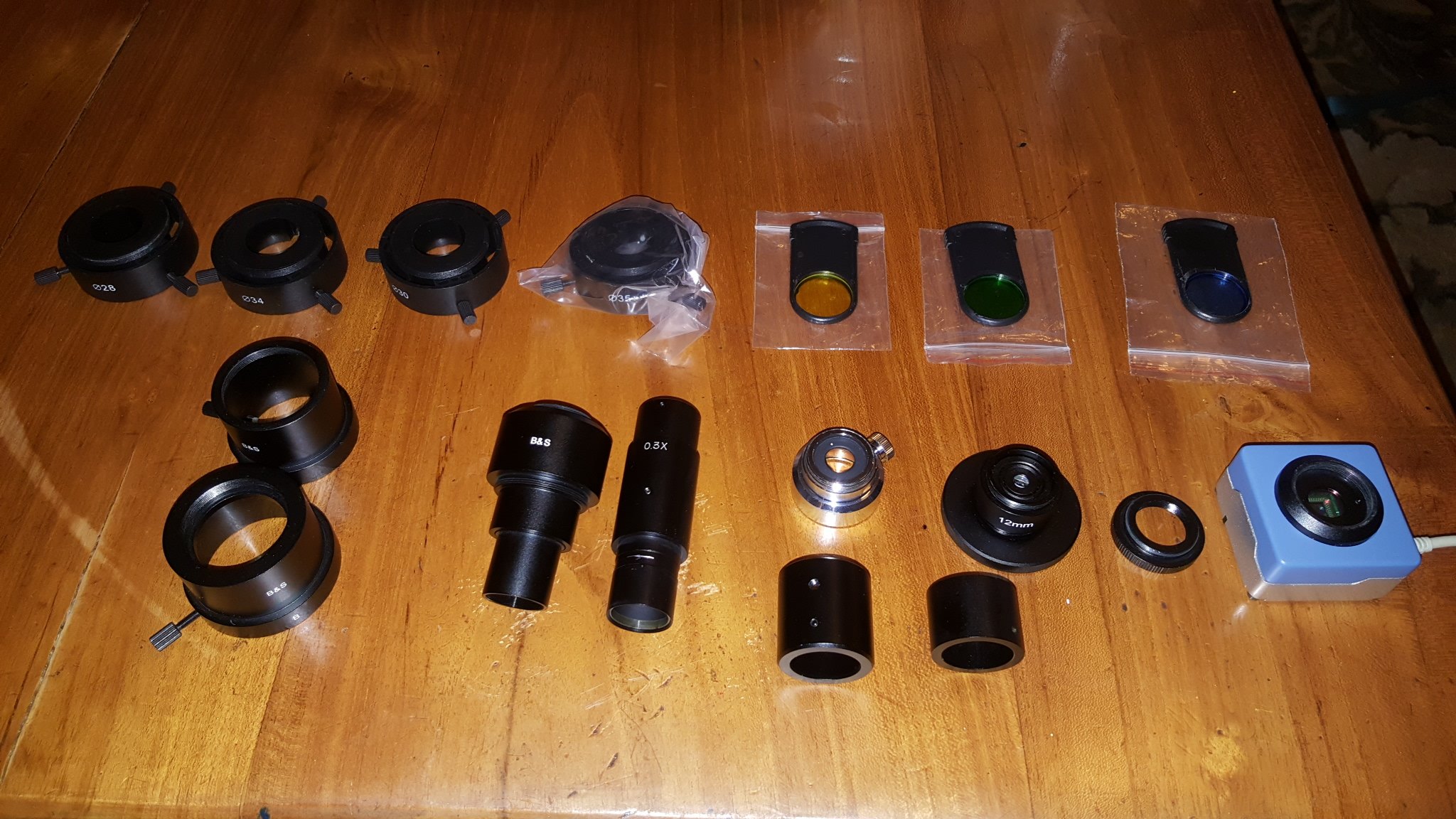

Great video, Cliff. Can you tell us which camera is the 2MP camera? Is that the metallurgy scope (with a camera/CCD–is that in the eye piece?)? It provides really clear images. And what did you do with this camera to improve the lighting?
Also, can you elaborate a bit more on the phone camera with the eye piece? You get surprisingly good results with it. I know you wrote a post about it, but I still wonder how you get such images with a phone.
Thanks Mark. The camera is a Motic 2000 2.0M pixel. It is being placed on the downtube of a trinocular head metallurgical scope, the MT1000T. I just got off the phone with Motic and they are being super helpful. Apparently I don’t have all the little adapters connected for optimal usage. I email this photo and am awaiting a return call when hopefully he will walk me through how to plug it all together as it should be for use in the downtube as opposed to the eyepiece position which it was set up for when I got it and didn’t know.
The specs on the Motic cam I could find are:
<1/2" CMOS 2.0 Mega pixels (1600 x 1280) with USB 2.0 PC output With 16mm CCD lens 28, 30, 34 & 35mm eyepiece adapters B & S Adapter (Camera to eyetube)</td>
The correct lighting, not including filters, involves a basic principle of modern microscopy called Kohler Illumination. The science of it is much harder then practical application. This video shows the concepts…I have been trying to match my hardware to something like this procedure. Keep in mind I’m in early learning phases of my own gear here and I just got the manual for my scope yesterday so the lighting setup procedure is also next.
The cell phone method is interesting but fiddly. The Carson adapter hold the phone in position(not very well) and I have it set for voice activation so can do no touch photos.
Its really to early to tell which is better, especially now that I know the Motic cam wasn’t installed correctly with all the adapter lens. Makes me really wonder if I could do better with the cell phone CCD sensor after playing around with others accessories as well.

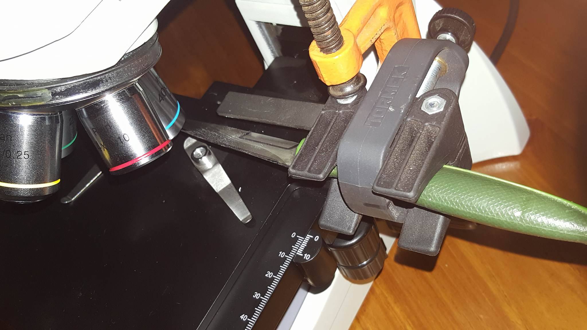

That’s exactly the same setup I have on mine! So glad you mentioned it because I had no clue and the manual is more of a quick reference guide. The only thing my manual mentioned was to keep the 2 levers at the same level but I find Im getting better contrast with the condenser one(I think) a bit lower…there’s really not that much adjustment.
The real adjustment I have found so far is in the angle of the knife and being able to rotate the handle and secure it again firmly, observe the image, rotate & repeat until its where it captures well. Today used a small C-clamp to mount a tormek small knife adapter to the side of the table. Not perfect yet, but it works…lol.
Good Idea on the Tomek Jig Cliff. I am still using play dough to adjust the angle, however, with the blade handle extended out, I am limited to a small section of the blade for now. I am thinking about and saving for Clay’s jig or something like it. Like your scope, I need to be cognizant of the room available under the objective lens. My “Helping Hands” set up is pretty effective when needed (Here).
