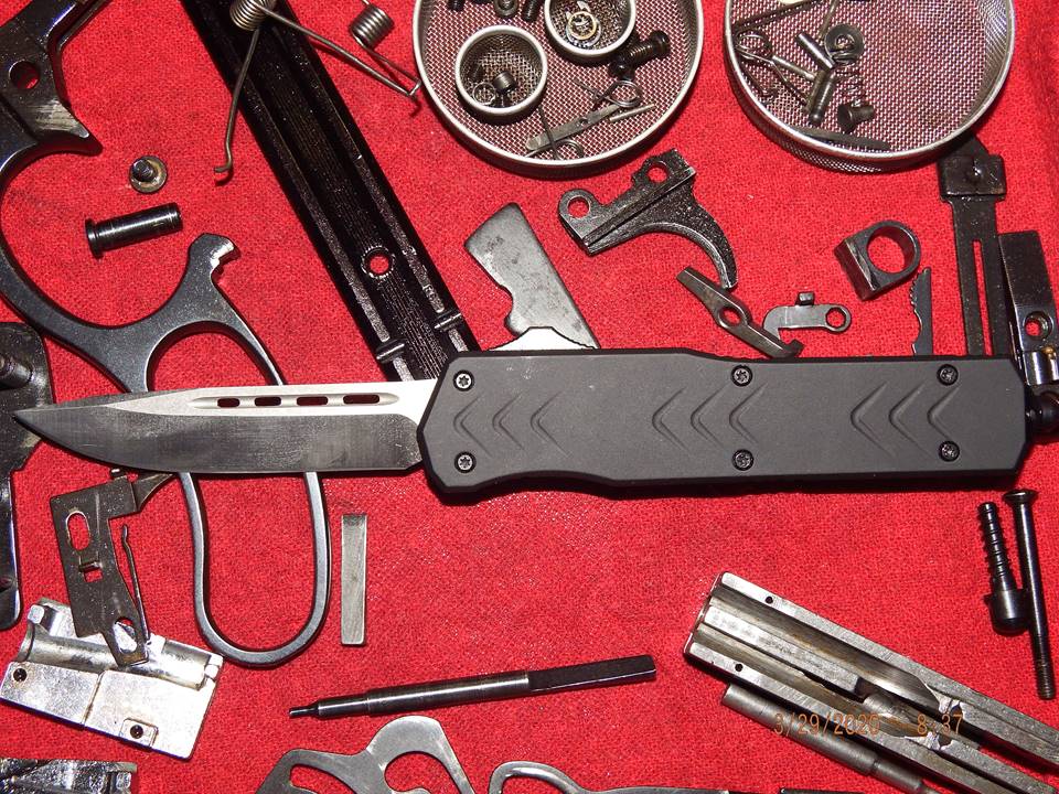

I disassemble my OTF for sharpening. It makes it easier on the vise and I can also clean everything good and oil it up easier when it’s disassembled. Plus, I just enjoy taking them apart. You can also measure the spring/springs and see what size wire you need to order so you can make a new spring in case the spring/springs break on you. My OTF is a Chinese made one that has one mainspring in it and it didn’t last long before it broke. I made some new springs with .020" 304 stainless steel wire from McMaster-Carr. Good luck with your OTF. Let me know if I can help you further.
Thanks for the thorough reply. It’s interesting that the blade on your OTF looks similar (or identical) to the one in my CobraTec. I’m going to take mine apart to learn it’s workings and better access blade for sharpening on my Wicked Edge.

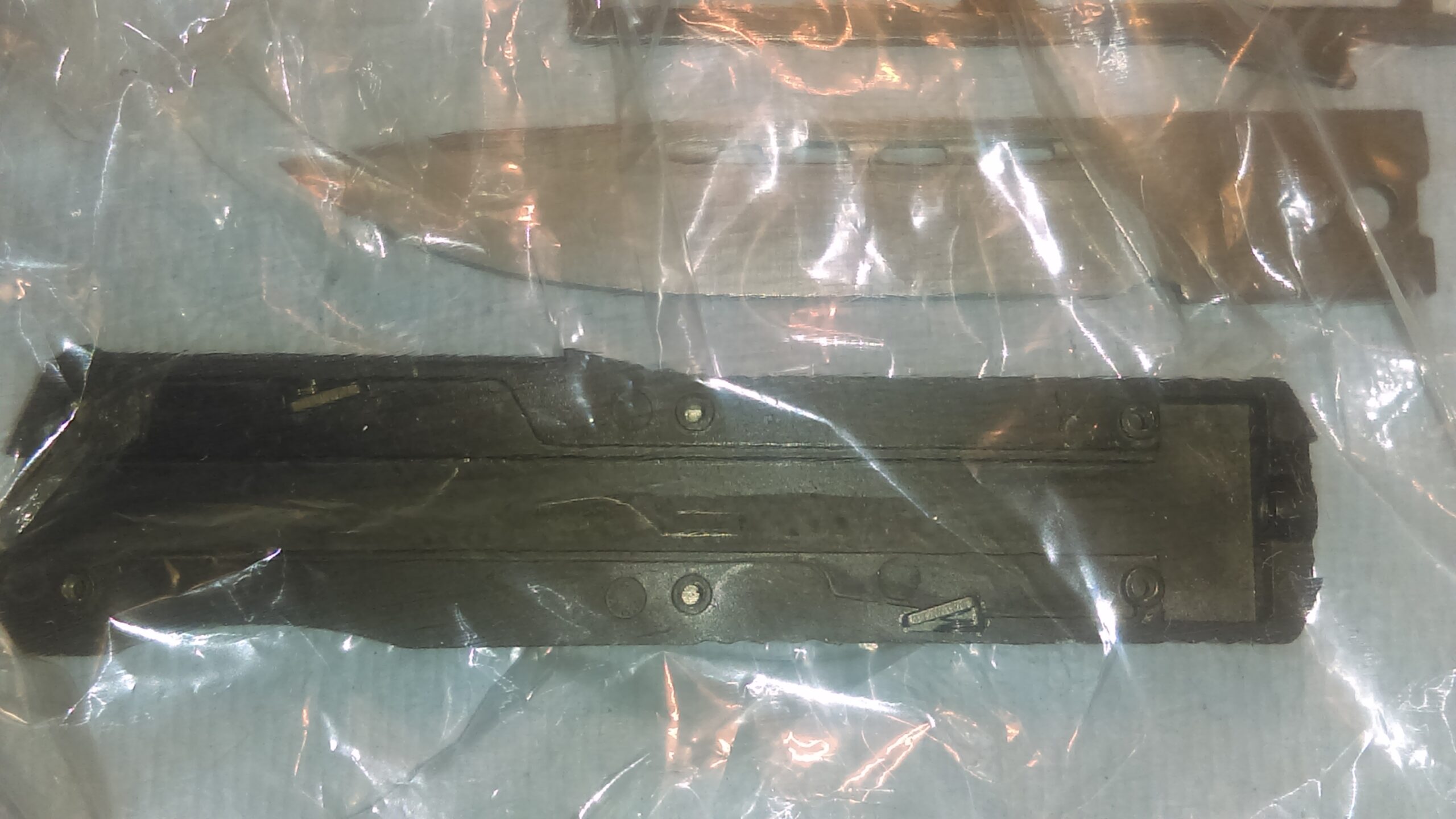

You’re welcome. Yeah, they do look similar. You can use some thick clear plastic to put your OTF inside of when you take it apart to make sure a spring doesn’t fly into never, never land. I use some thick plastic bags that I bought to keep my old concert T-shirts in. They have saved me a lot of aggravation!
