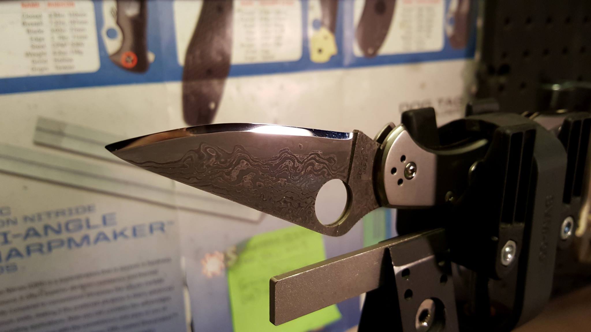

So I have been searching on here and can’t find the answer but to be fair I suck with the technologies lol. So can it be done? I have seen folks say a true scandi is like 8 dps so it’s not really possible. I have the gen 3 pro set up. I was wondering with the W/E low angle adapter or whatever it’s called would it be possible or am I wasting my time. I have only done about 3 knives so far but am having great success. However one of my favorite grinds is the scandi grind and I would love to be able to sharpen them on the W/E. I know on the info page with the low angle adapter is say with the gen 3 you can get to 9 dps but was wondering if with the extra play that is left in after the 14 degree mark would it get lower. I figure I would have to use the angle cube to make sure I can get it repeatable and see the exact angle.

I’ll have to look into it a bit more. I put the stones up against my Pohan Leu and laid the stones on the side to see if they would line up. I took it to 14 and it still wasn’t touch all the grind. it was hitting the bevel and about 3/4th’s of the grind. I took it to past the 14 mark and it got a lot closer but still wasn’t there. I’ll have to look with some of my other scandi’s. Maybe try it out on a mora so if it doesn’t work I’m not ruining my bluefin flipper lol

thanks for the advice everyone. I put a mora on it last night and it’s definitely below the 14 dps mark to hit the whole edge. I think with the adapter though it would probably work. I might give cliffs suggestion a go though as it’s slightly cheaper and looks like it would work well also. I’m going to grab a few different cheap model scandi’s and see what I can come up with for it but I definitely think it’s possible with some work and attachments. On the mora I had on it last night at the lowest dps setting I could get which appeared to hit the whole grind I couldn’t do the back half of the blade because the stones were hitting the W/E clamps
